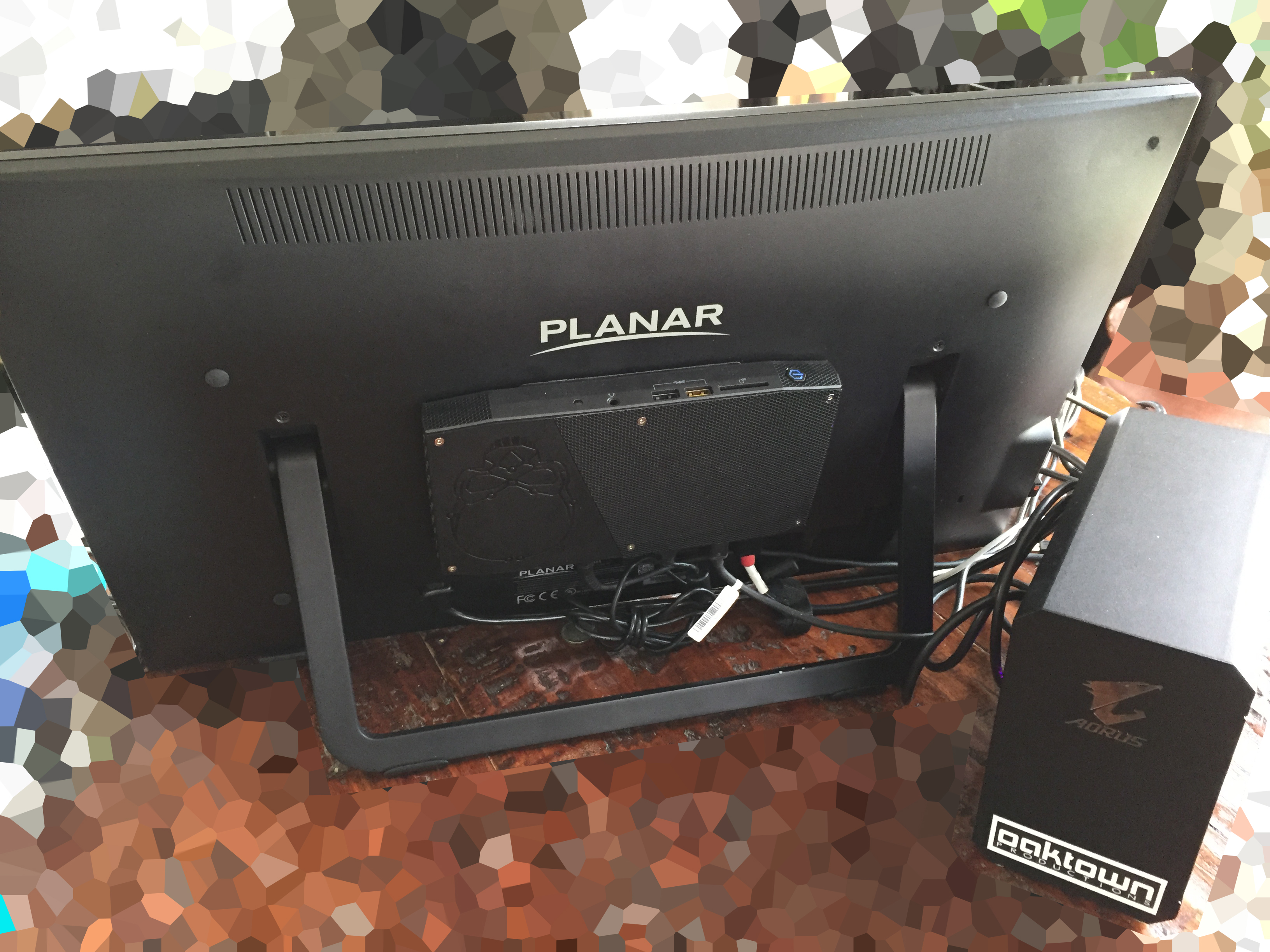

Here is what it looks like with the Skull Canyon mounted to the Planar screen:

Various reasons:
1) the ability to use all these parts independently as needed.
2) in case of failure I can easily and cost effectively replace any of the parts
3) 24" touch screen is awesome?
4) a comparable laptop with a 1080 card and 32GB RAM is not easy to find for $2,500
5) I can use the Skull Canyon on its own without the touchscreen or eGPU for smaller projects and it's easy to deploy.
6) The same setup can be used as a rendering station when I'm a bigger gig
7) This can also work with Dataton Watchout other media server type software such as Notch, Touch Designer, MadMapper, and VMix (since it has a TB3 port I can use other chassis with PCIe cards)
8) And yes, "just because I can" ;-)

Re: Skull Canyon and eGPU
Here is a quick update to report on this NUC Skull Canyon/eGPU system.
I've used it extensively for long-run shows over the last few months and I've had absolutely no issues with it.
My typical setup would be to use the AORUS GTX 1080 8GB TB3 Gaming Box with two outputs:
[*]Displayport to the 24" multi-touch monitor
[*]Dual-Link DVI with a Gefen Dual-Link DVI to Fiber Optic adapter to send signal to a Datapath X4 at 3840x2160/30 or 3840/2400/30 to be split into four outputs
I've built rather large compositions with many layers and the system is always very stable at 30fps.
My next project is to build a couple NUC8i7HNK (Hades Canyon) units with similar setup as this one and test them without eGPU as our new highly portable media server.
