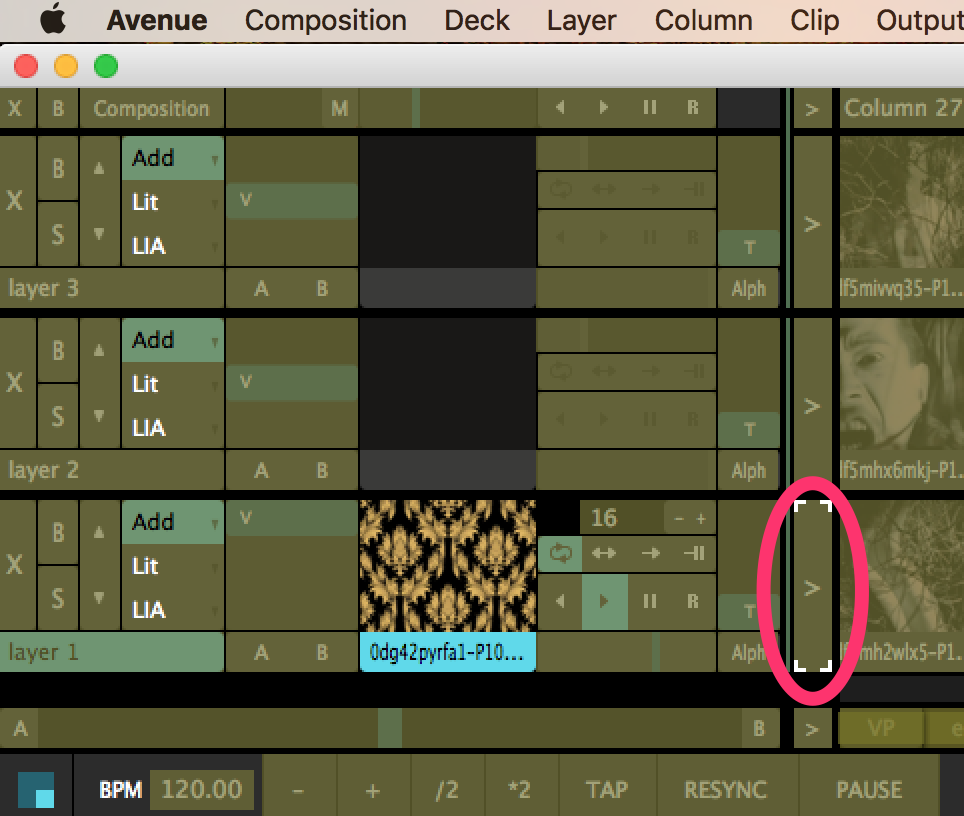

However i often find it difficult to control the slider along the bottom of the deck because it's a little too thin to easily grab with the fingers.
Is there any easier way to control it, other than by using the trackpad which can be a bit fiddly?

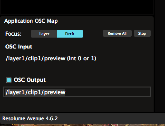

You could try to use the layer MIDI move map. Downside is it will immediately trigger the clip you are cycling through.
Using OSC you could try specifying a Preview clip value, but you would have to set manually increments of (for example) 12 clips (unless some other more clever individuals here could scrip it).
/layer1/clip1/preview
/layer1/clip12/preview
/layer1/clip24/preview etc.

i tried the layer MIDI move arrow as you suggested (i hadn't noticed that before!), and it did work, but as you say it was loading up clips as i scrolled through which wasn't ideal.
So i decided to go with your other suggestion using MIDI mapping to my MIDI controller buttons (i've never used OSC & the midi works fine).
So i've assigned a row of buttons on my midi controller to the preview of clips at regular intervals in my deck.
It works great!
