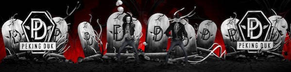

California was initially developed in TouchDesigner to carry the freeform sections of the show but it is now used throughout. Basically I'm using TouchDesigner to do audio analysis live, then I render a trigger based texture palette of sprite animations. They are very simple solid pulses, gradient ramps, animated noise that respond to audio. I send these rendered textures over to Resolume via Spout and position them behind alpha channelled layered animations using Visution Mapio on a layer and column basis. I then launch column compositions instead of running a solely clip based show.
The generative element gives the show added life. Having an automated element sitting behind what I’m doing live broadens the scope of the show and creates a much tighter visual experience overall.
California
California

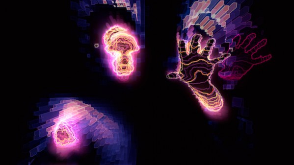

I jumped on laptop VJing as soon as I could. Originally I was pushing out 3 layers of 320x240 on Resolume 2, which seems ridiculous now, but given the tape-to-tape alternative, at the time it was revolutionary. Resolume is still my core go to performance application.
I’m a bit of a control scheme nut. I have a somewhat ridiculous midi controller collection and I'm always working on new control schemes. My TouchDesigner work creating custom performance interfaces is just an extension of that. I’ve always wondered what touch screens or motion controls like Leap Motion would be like in live situations so I created my own custom tools to integrate these elements into shows. Having my own tools removes many technical limitations and allows me to focus on the creative. For me creative is always at the forefront but sometimes there are technical hurdles to navigate first.
