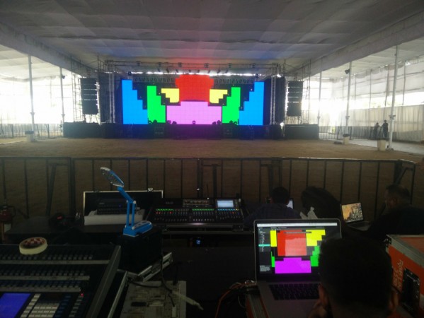

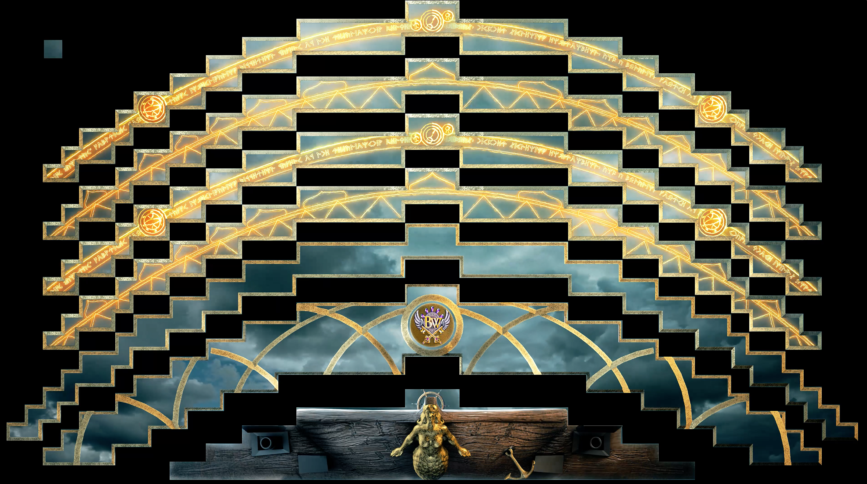

Tell us the process you follow for pixel mapping.
It starts with us coming up with a stage design, which we conceptualize from scratch or is given to us by the client/ festival. Once we get the tile sizes and resolutions we figure out a way to create the most effective pixel map. One that can fit custom content and existing 1080p content that will look correct moving across the entire stage. Doing a 5-6 hour music festival is not feasible on custom content alone. If you have the accurate outmap map as well you can do most of your mapping from the hotel room itself. Aside from a few onsite tweaks.
Resolume offers mapping and playout of content in the same platform, very few other software offer the same with the ease of access and user-friendly interface. The snapping features, keyboard short cuts and the ability the set virtual displays makes mapping on Arena a breeze.

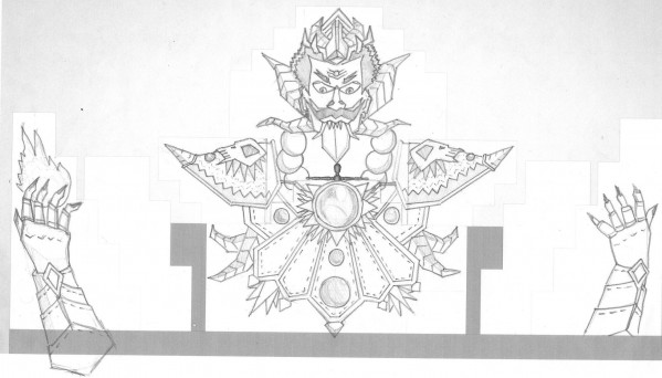

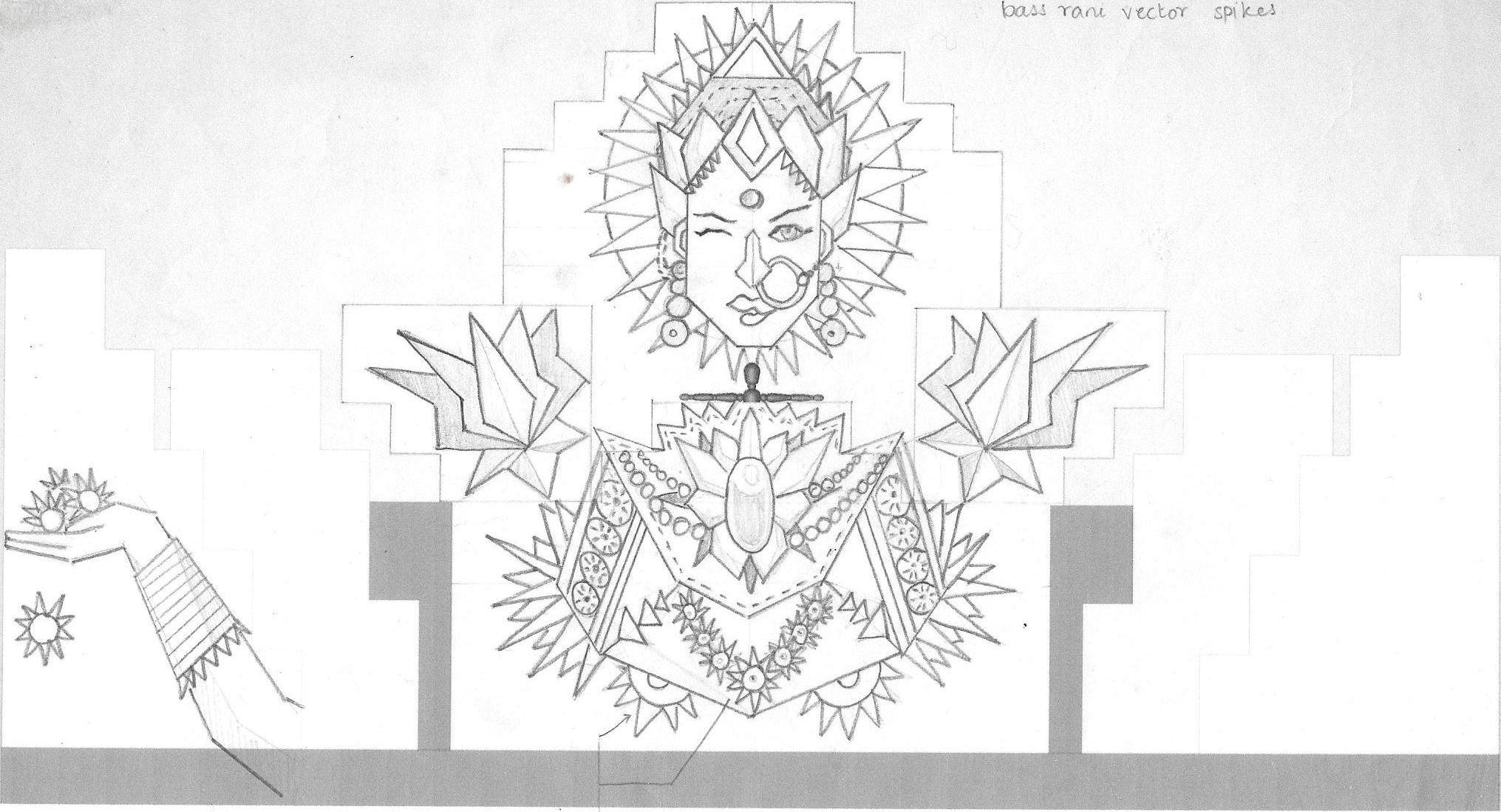

1) When Nucleya’s team approached us for his Bass Yatra Tour, we had around 600-700 sq ft of LED available and that many different versions of the LED layout to explore. We do a few days of pure illustration work along these layouts. Sometimes things just don't click and we break it up and start again. There’s a moment where the practicality of having this layout on stage meets this insane war demon sketch you’ve been rooting for in the start, and then we all sleep well at night.

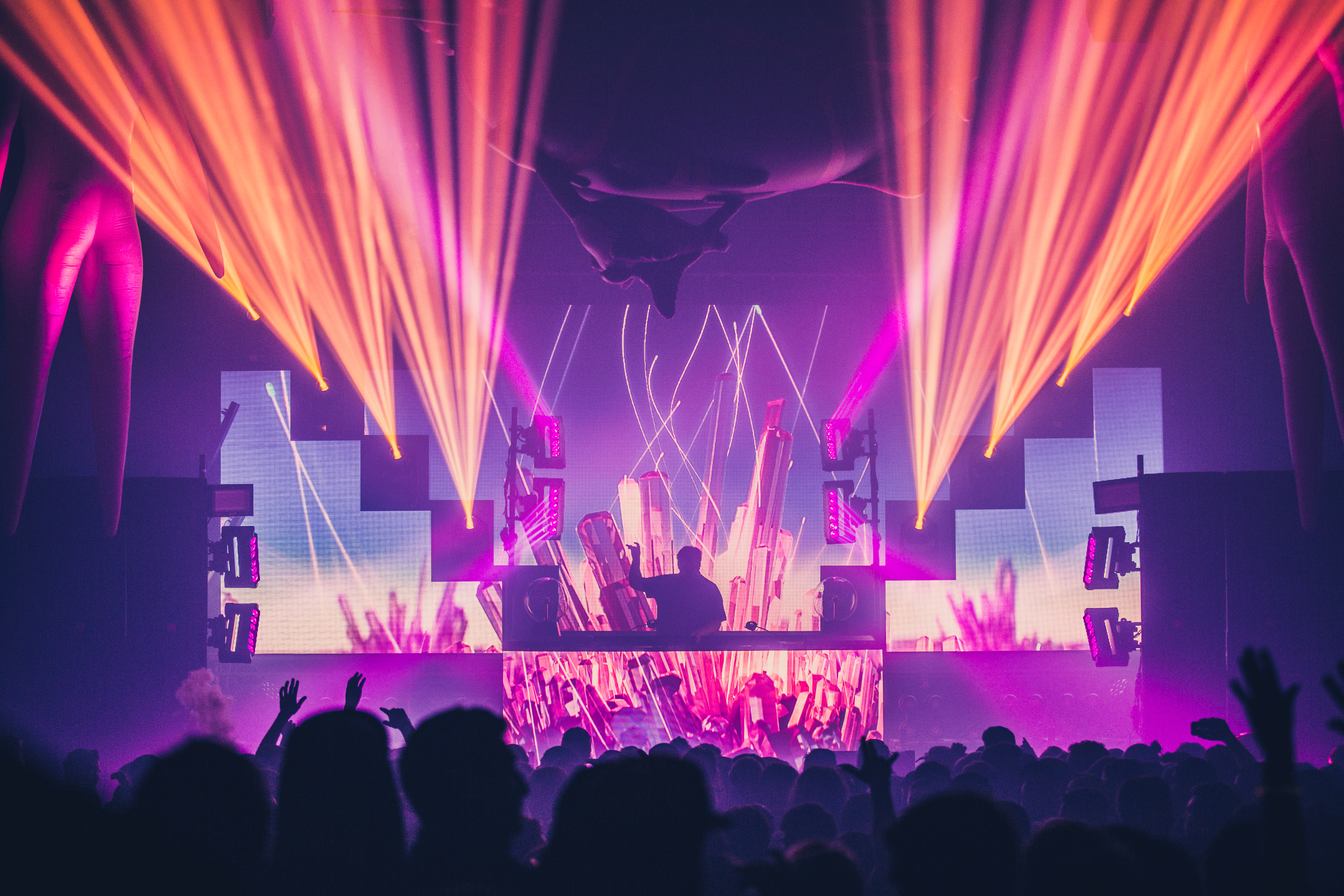

2) Some of the bigger stages we’ve done like the ‘Outer Realm’ stage at Beyond Wonderland in Los Angeles throw a real curve ball at us. The stage had multiple narrow arches extending from the stage over the audience with very little room for seamless content.
We took it upon us to create two worlds loosely themed as — An Enchanted Forest and A Lost Ship — and somehow adapt it to the whole spread of LED. Keep in mind this was for a stage hosted by the incredible Bassrush crew and we knew things were about to get heavy. Those pleasant environments gave way to a forgotten labyrinth of cogs and pipes powered by a mechanical eye and a set of makeshift Icarus wings - and it all fit!
3) Fast forward to the Flux Pavilion tour and we’re working with a limited itinerary. The production company and label (Bigabox Productions and Circus Records) stock their LED in-house and had to scale it down to a realistic number of panels that would tour safely across all cities and fit in every venue. When they gave us the LED layout and pixel map, we were determined to follow through and not fallback on a 16:9 screen.
The other half of the conversation was with Flux Pavilion himself who had a very distinct vision of these worlds he wanted us to create for different sections of his set. It really pushed us to get a collective vision across that would fit on four sections of LED (one being the fascia) and still be immersive enough to draw audiences in every night.
We ended up with one hell of a ride — a quirky intro feature that draws people from the a scenic British landscape to the strange worlds of Flux Pavilion. At one section of the we have a bionic ship carrier take over the LED and transport him between these worlds. At another, a mad-scientist rig of electricity Pylons take over the screens and charges up flags made of coloured electricity. It gets weirder as we go on, and we’re pretty much developing these worlds as we go along on tour. Every night’s had a great response and we cant wait to see what the show turns into. [/i]

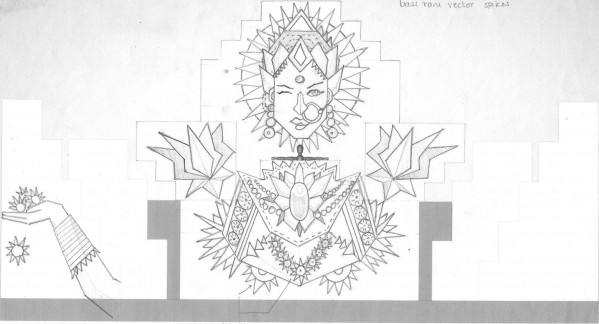

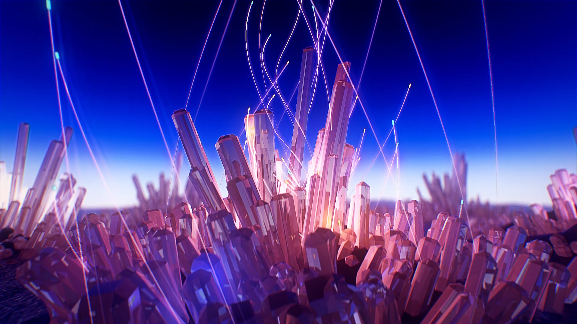

We throw ideas back and forth to settle on a base LED design or projection surface. Once thats finalized, we start to sketch over it- not only does it help control our ideas, but it also assures we’re creating something that will no doubt function at every step.
The sketches are then scanned, digitized and modelled in a 3D realm. We then gather up as many parts as possible to see what we can play around with in terms of animation. We start of with Illustrator to vectorize the sketches and then move on the Cinema 4Dfor the 3D modeling and animation. Post that, its taken into After Effects for final compositing and animation.
We have a great team on board that makes doing all of this such a breeze. They work round the clock and deliver spot on content. Shout out to them!
It can take anywhere between one day to around three to four days based on how complex the clip is in terms of 3D animation and texturing and lighting.[/i]

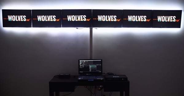

Let's take a walk through your studio. What hardware do you use, what is your most prized possession and what would you like to change/ upgrade?
Like most VJ's out there, we've also realized that the macbook pros just don’t cut it anymore. The heating issues, performance related to the AMD cards and throw in the 'Donglepocalypse', its a no brainer. We've switched to windows laptops for our tour machines.
We're currently using the Octane II from PC Specialist.
Specs:
Intel® CoreTMi7 Quad Core Processor i7-6700k
32Gb Ram
GeForce GTX 1070
1 TB Samsung SSD + 1 TB Seagate Hybrid.
For display outs they have 2 x mini DP, 1 x HDMI , 1 x USB C/Thunderbolt 3.
For our live feed needs we use the Magewell USB 3 to HDMI capture card.
We’re using multiple Windows servers for content generation with dual GTX 1080 GPU’s and the Intel i7 5960x CPU, 32 GB of RAM and 2TB SSD’s in each machine.
