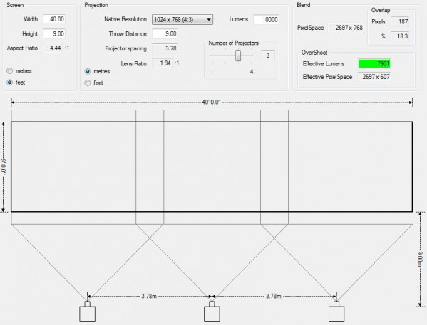

Firs there are good programs for this kind of questions
1 http://www.wookiesoft.com/WookieSoft/BlendZ.html
2 https://sites.google.com/site/audiovisualwiki/blendcalc
They both calculate projection area distances , lens ration , blending% and all the stuff you may need for this kind of project.
In your case if we take that you are using standard rental projectors with standard optics for Panasonic ( 1.8-2.4:1) and native resolution of 1024x768 for example, If we take it that you will be using TH2Go and we calculate your projection area to the number of projectors you can connect ( 3 ) this means that you will loose pixels . Meaning the pixels that will be on the object are less than what you can output from the projectors.
See the pic below to understand what i mean.
There are ways not to loose pixels but you have to change optics or throw distance.
Anyway this is the basic idea, things are not as simple as they look.
If you have questions, ask.
And ppl when they guy doesn't know what questions to ask, help them by guiding them ...

BlendCalc looks good. But for me it's not possible to install the software? any idea?...
deepvisual
Posts: 80
Joined: Thu Mar 31, 2011 15:49
Re: One big Screen with multiple beamers and one output (lay
Post by deepvisual »
vjsynth
Posts: 9
Joined: Tue Nov 23, 2010 21:54
Post by vjsynth »
cosmowe wrote:BlendCalc looks good. But for me it's not possible to install the software? any idea?...
Go to the website , download he ZIP file and open it.
Now inside the zip you will have a folder "Application Files" go inside is another called "BlendCalc_2_4_0_0"
inside all of it there are a bunch of files.
BlendCalc.exe.deploy is the one you want. Extract it wherever you want and remove the .deploy extension so it becomes BlendCalc.exe
Start it and enjoy.
