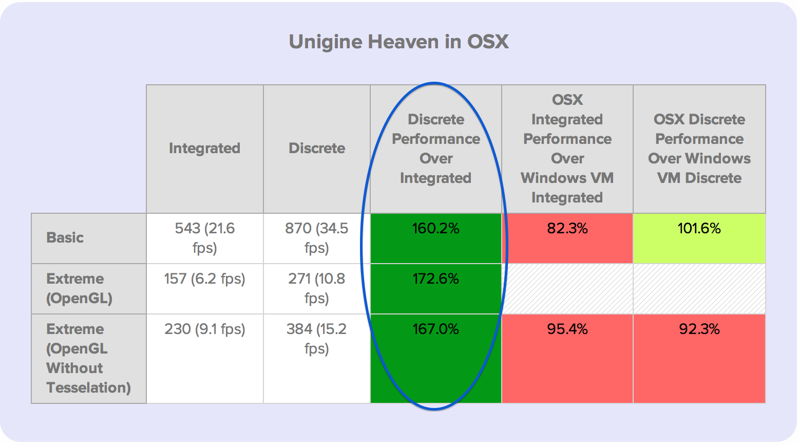

I looked at the article you referred to in your first post and unless I'm missing something, the Unigine Heaven test corroborates my opinion, right?
Keep in mind that like most everyone in this forum, you'll want to connect more than 1 external display so the best way to know will for you to go test both systems with two or three 1920x1080 displays connected to the laptops.

Those benchmarks are all about 3D rendering performance. I'm in no way doubting that a discrete GPU is able to outperform an integrated solution. The only reason I supplied the article link was to show that there are also unexpected outcomes, because you can see there are a few tests where Iris Pro was able to keep up with the discrete GPU. In a Windows VM there was even a game which performed better on the Iris graphics. This has everything to do with how software is implemented and how the different features of drivers and GPU resources are used.
And this is why I think you shouldn't blindly trust that the 750M will outperform the Iris Pro by a long stretch in every scenario. Like when your GPU is mainly concerned with video decoding.

I don't blindly trust the GT 750M, I use it all the time for shows and it performs amazingly well. All I'm saying is these tests you're referring are rather irrelevant since they are testing the Iris Pro vs the GT 750M using the Retina display of the Macbook Pro not an external display. I'll be curious to see the results when you get a chance to test two Macbook Pros (one with Iris Pro only and one with Iris Pro & GT 750M).
