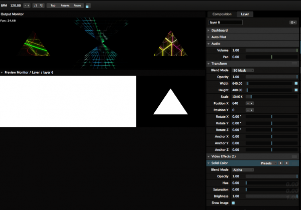

Blend modes always affect all the layers underneath them, that's the way things work in Resolume.
To make the other layers visible, you'll need to somehow make the areas outside of the clip white. There's two ways you can do this. One is pretty straightforward, just re-render your mask clip on trips resoluion on a white background.
The other method is quicker, and doesn't require re-rendering. Apply a Solid Color effect on the mask layer. Switch the render order of transformations and effects. Now set the Saturation value to 0 to make the Solid white, and toggle Show Image to bring back the original clip on top.
Hope that helps....
