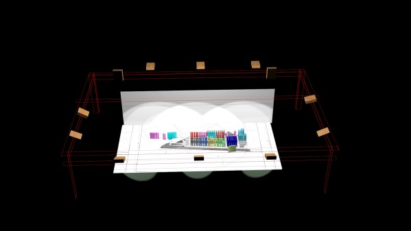

I was planning on using 4, but I could probably use 2 and 1 backup by connecting 2 tripleheads on each server to give me 12 outputs. I may need to add an additional projector in case 12 don't cover the entire area, but if that's the case I can always plug it in to one of the additional outs on the graphics card.
Servers havent been built yet.
Composition will be 5760x1080 (since the triplehead gives me 1920x3, I could also lower it a bit) and im looking at running 2-4 layers at the most.
As for the compositions, some clips will be the same on both servers and a few will be different because each server and the projectors connected to it will take care of mapping a different area of the scale model of the city. So I'm going to have to render my content from different angles and project it on the scale model (I'm attaching an image for your reference).
So I think the simplest way to do it would be to find a way to trigger the same clip on both servers at the same time? Let me know if there's another work around and what you think?
Also I was looking into Vezer, If you think that's an easier option, you think you could maybe link me to a tutorial on how to set the whole thing up? I can probably get the client to get us a macbook if I cut the windows servers down to 3.

tripleheads will output 1920x1080 at 50hz! check your projectors if they support that refreshrate.
check the link in my signature, it is a windows program that would allow you to trigger multiple servers from one PC.
btw, that's a lot of projectors, what is the distance of the projectors to the model? what projectors will you be using?

I only have a distance of 5.4 feet to project from.
So I'm using Panasonic PT DZ870 8500 lumens projectors with the ET DLE 030 ultra short throw lens.
The 2 projectors directly above it will be using the ET DLE 085 lens.
In case the projectors don't support 50hz.
I can drop the res down to 4800 x 900 (3 x 1600 x 900). Do you foresee this as being a problem?
