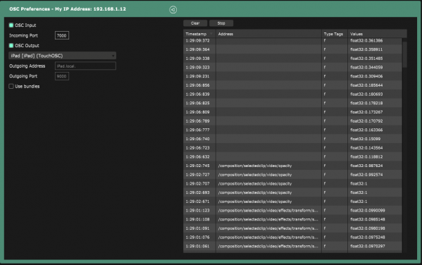

Could you check if you actually get these messages into Resolume via the OSC inspector in preferences?

its not coming in with a command
