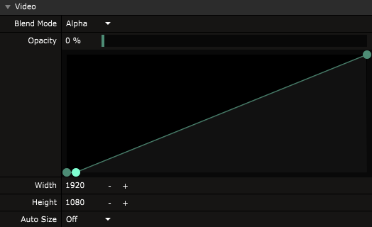

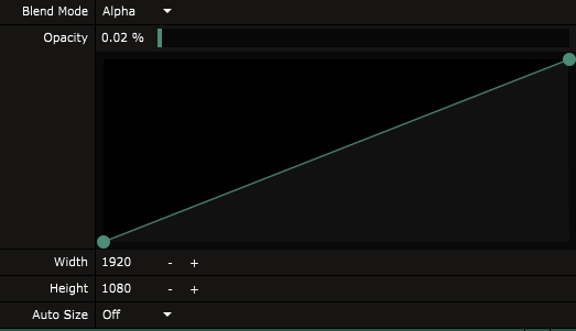

Envelopes on the layer opacity breaks on fader start clips. When I enable envelopes on a layer opacity the minimum value achievable is 0.02. I've noticed this on Composition effects where you have to add two points on the curve near the zero value to achieve an absolute zero amount.

Thank you for letting us know.
It will be fixed in the next release.
