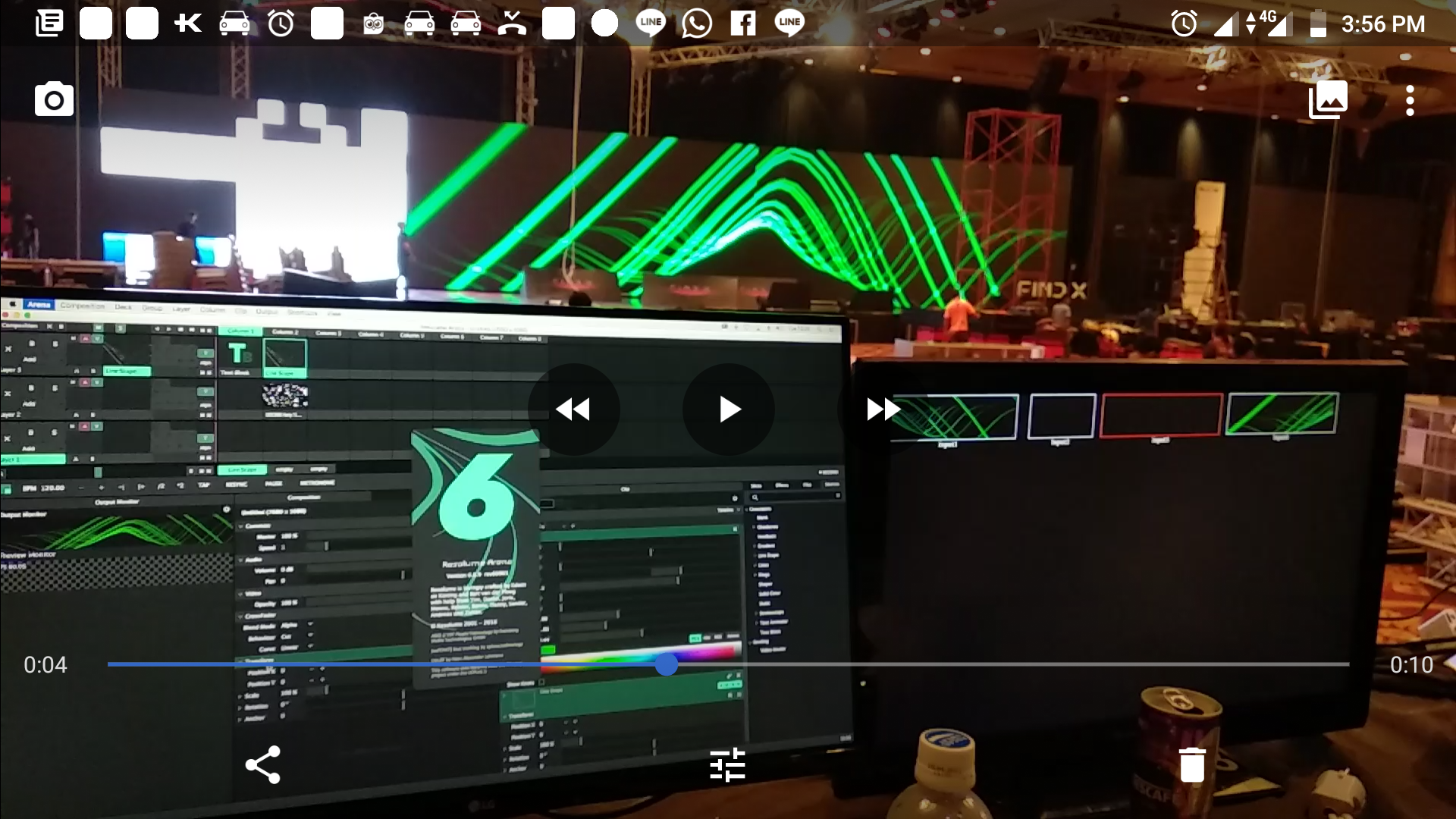

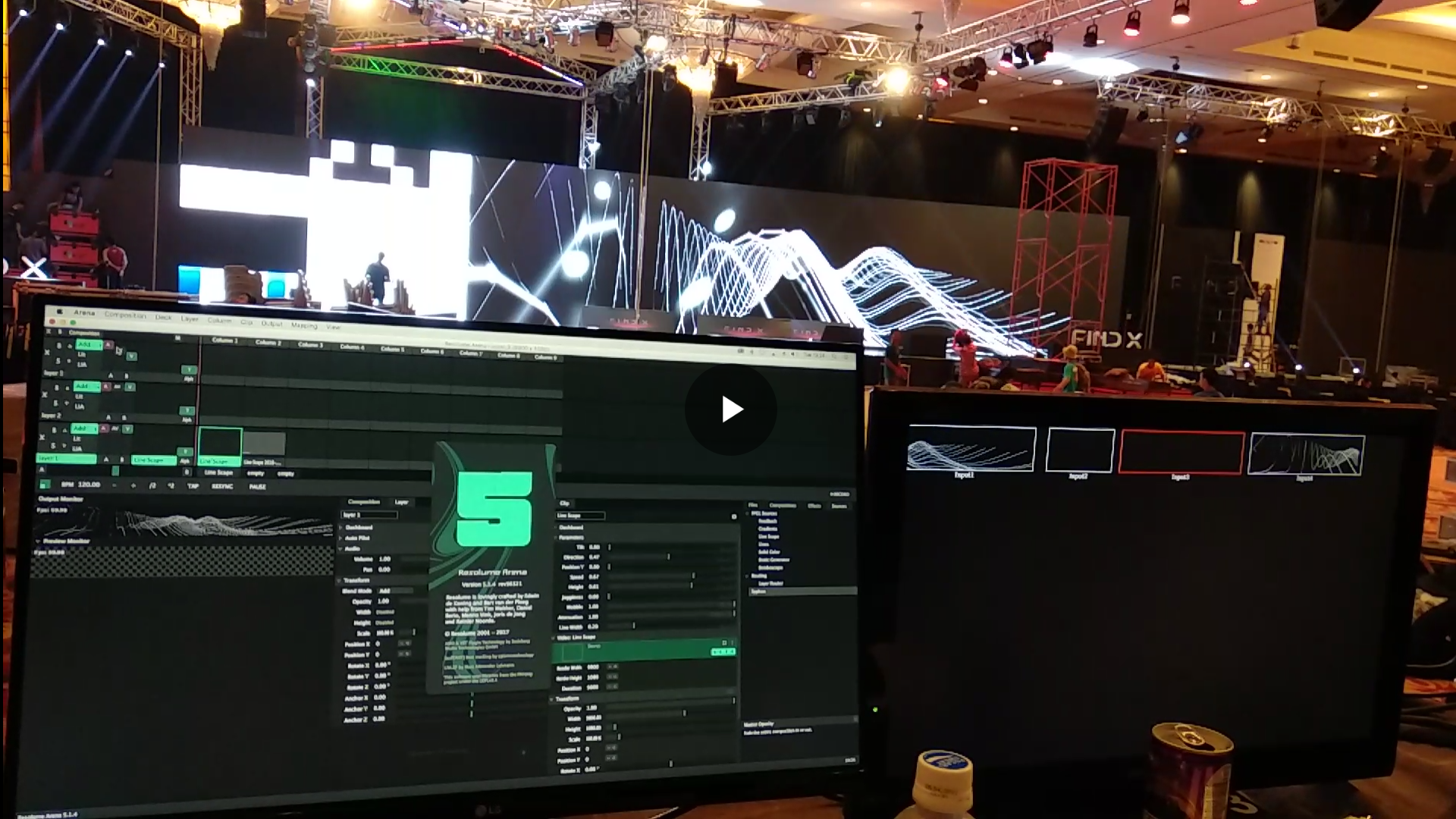

hi everyone,
Sorry for my poor english
I have throuble with tearing betwen output..
My setup:
Macpro late 2013
3.5GHz 6-Core Intel Xeon E5 processor
16GB 1866MHz DDR3 ECC memory
Dual AMD FirePro D500 with 3GB GDDR5 VRAM each
Storage 256 SSD
Connected with Barco Encore2 using 2 MDP to DP cable.
Resolution 3840x1080 each output.
The problem came up with resolume 6, but it doesn't show at resolume 5.
If you guys have any solution, please share to this forum.
Sincerly,
Bedoe
Recorded video:
Tearing resolume 6:
https://youtu.be/G3BC9Kmsjxc
No tearing resolume 5:
https://youtu.be/iU4OtwvB6-I
Resolume 6
Resolume 6
Resolume 5
Resolume 5

I think that's not an issue to be fixed, as you asked on update announcement.
Do you tryed to change your composition fps?
Posts: 7088
Re: Tearing issue
If this is a constant delay between outputs you see, you could try to add a frame delay to the Screen that is outputting before the other. https://resolume.com/support/en/screens#adjusting-delay

francoe wrote: Fri Aug 10, 2018 05:11 I think that's not an issue to be fixed, as you asked on update announcement.
I havent try that.. I'll try and make a report..
bedoe
Posts: 5
Joined: Sun Nov 05, 2017 19:17
Location: Jakarta
Re: Tearing issue
Post by bedoe »
Zoltán wrote: Fri Aug 10, 2018 12:14 If this is a constant delay between outputs you see, you could try to add a frame delay to the Screen that is outputting before the other. https://resolume.com/support/en/screens#adjusting-delay
It's not constant, delay only happen when show fast animation.. in slow video, it looks fine..
Posts: 7088
Re: Tearing issue
bedoe wrote: Fri Aug 10, 2018 12:24It's not constant, delay only happen when show fast animation.. in slow video, it looks fine..
You probably don't see it in a slow animation, because the difference between the frames is so low.
bedoe
Posts: 5
Location: Jakarta
Re: Tearing issue
Post by bedoe »
Problem solved
Thanks for francoe, i usually set the FPS composition to Auto, on this case, we need to adjust FPS comp.. minimum 30fps, if lower than that you'll see some Lag on video...
