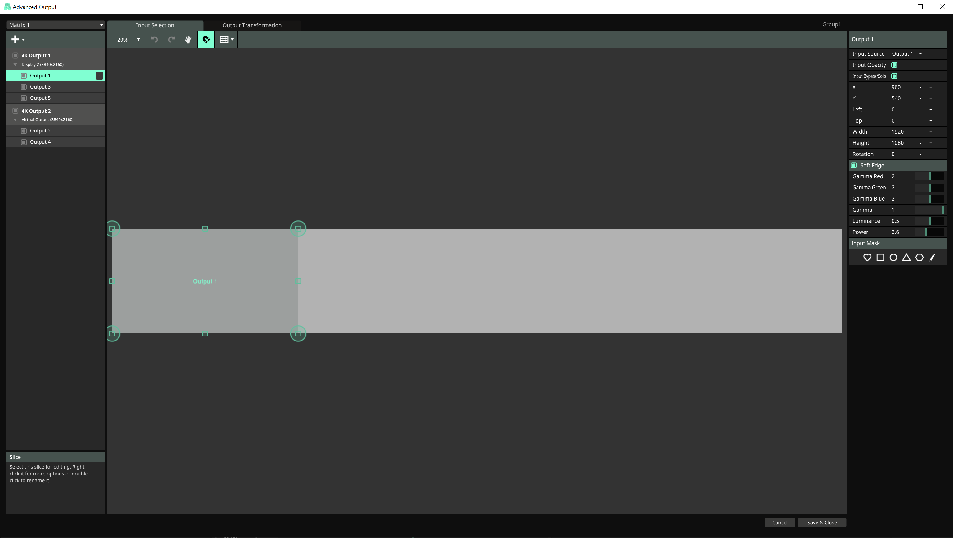

Hi everyone!
I'm having a bit of trouble getting my soft edges to activate. I have them activated for all four of my slices however when I make any adjustments, nothing occurs either inside Resolume or on my outputs. I have a 3840x2160 composition setup with four outputs. I'm wondering if maybe I am missing something obvious?
Using Resolume Arena 6.
If it helps I can post screenshots of my composition.

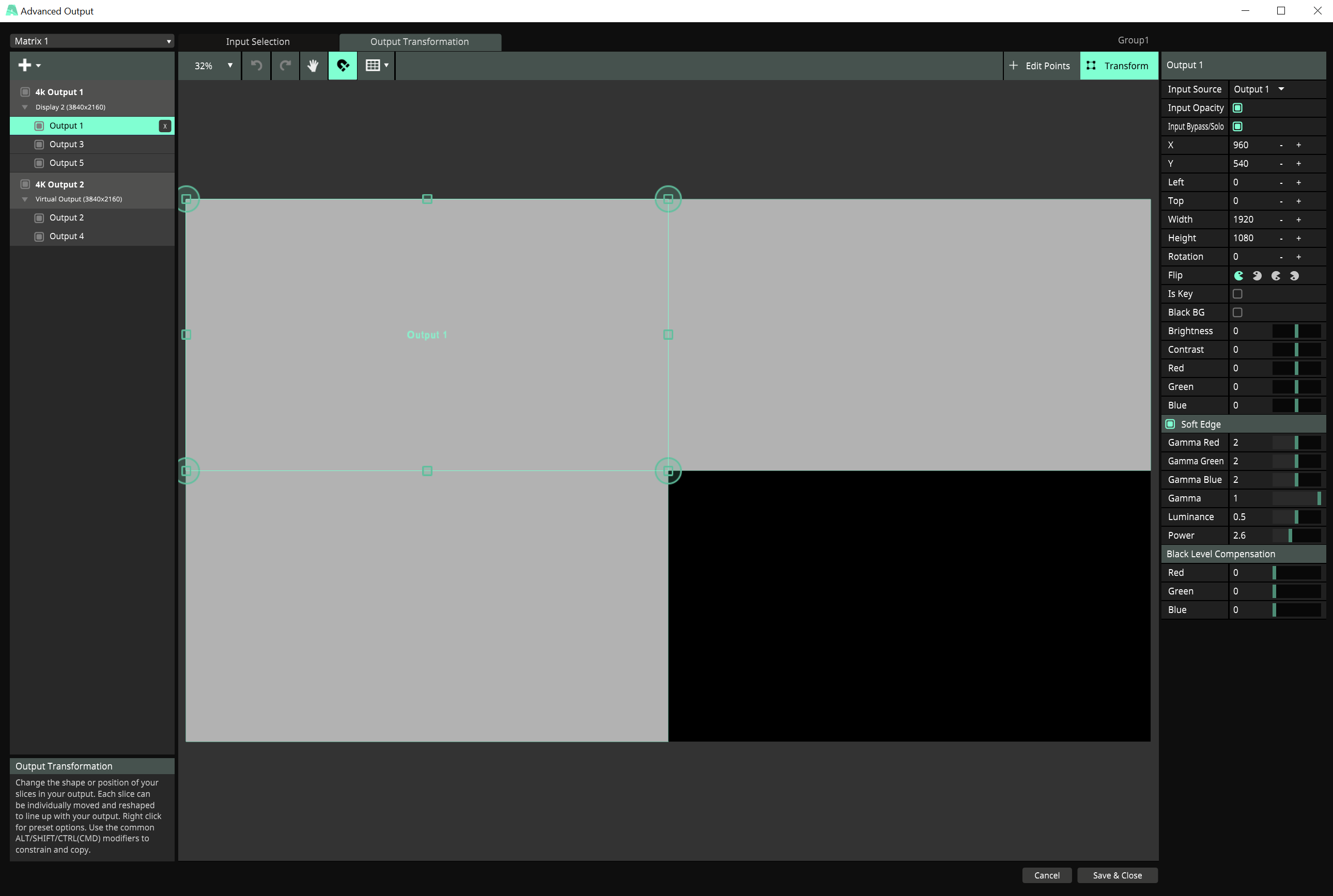

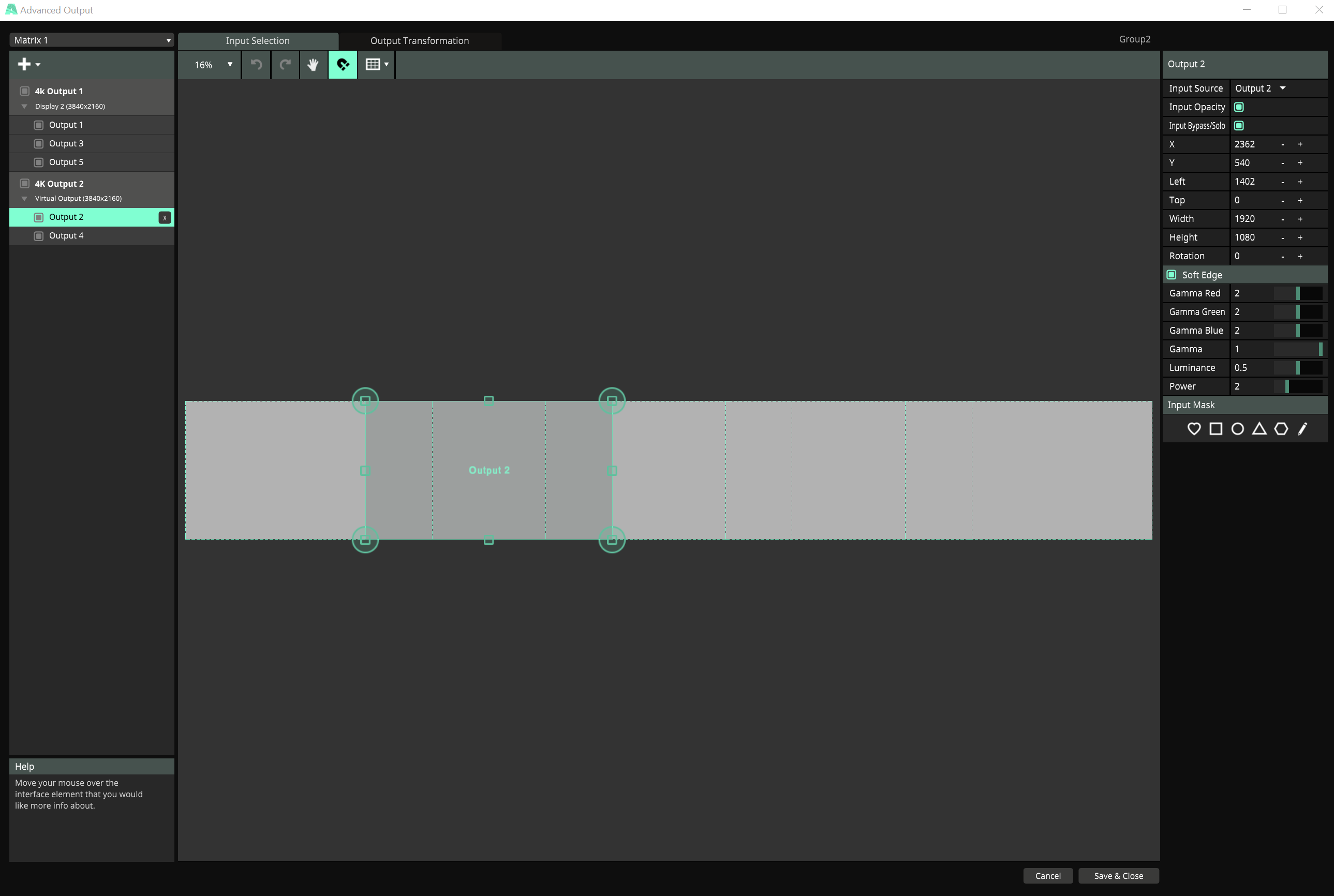

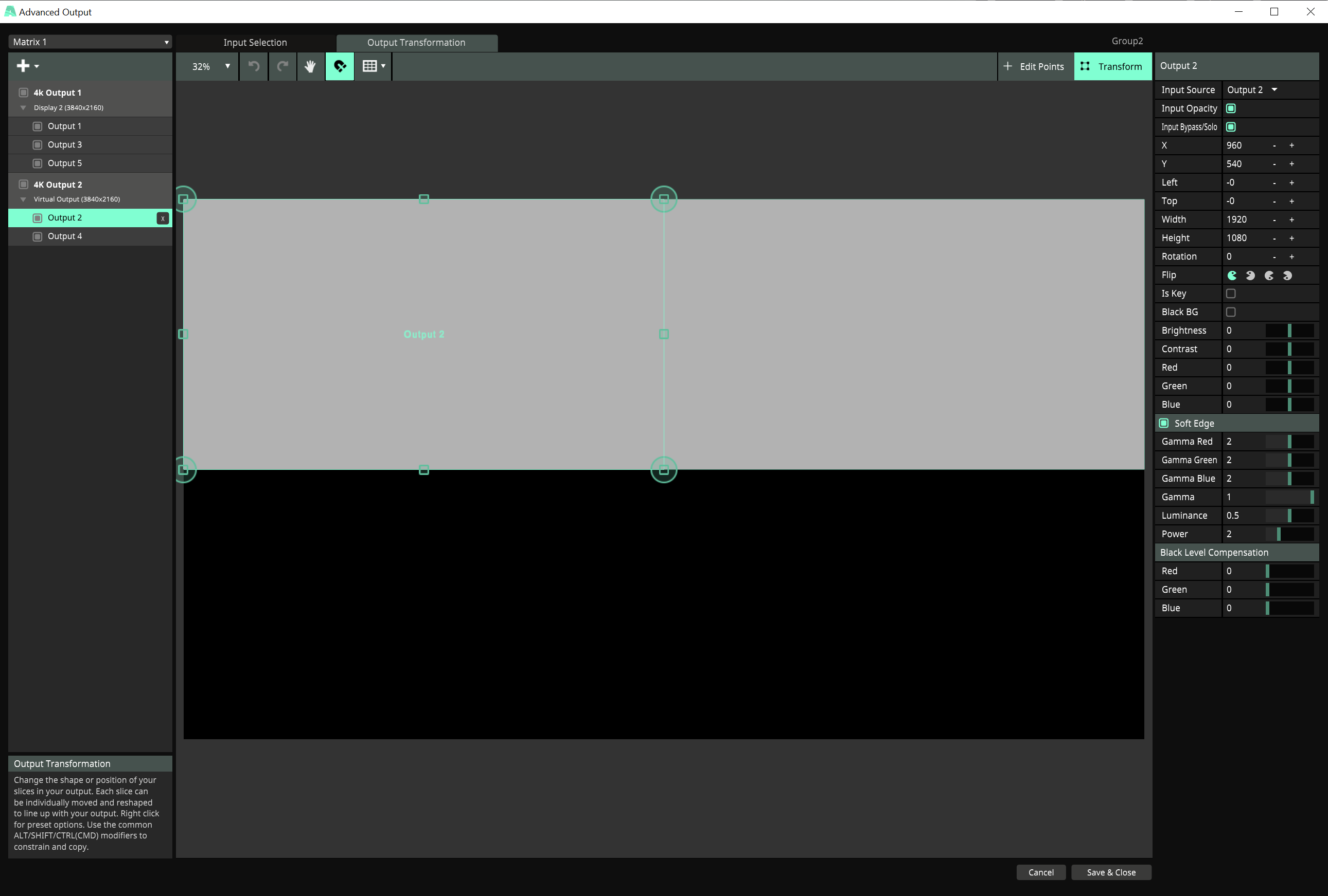

I am having the same issue, even when flip flopping slices between 2 different 4K outputs
Re: Soft edges not activating
Posted: Wed Dec 22, 2021 09:13
by Intange
Im doing a double quad split to 2 4K outputs of a composition thats 7526X1080. 5 projector blend at 27%.
Im not seeing the soft edges. Does it not work when you do a quad split?
Posted: Wed Dec 22, 2021 10:39
by Zoltán
Try setting the slice input to the same source.
Posted: Wed Dec 22, 2021 21:42
by Intange
Hi Zoltan,
It is the same source, its a 7526X1080 clip.
Posted: Wed Dec 22, 2021 21:52
by Intange
Ok I get it, I have to use the same slice source. Thank you, that works now. Awesome. I love Resolume.
