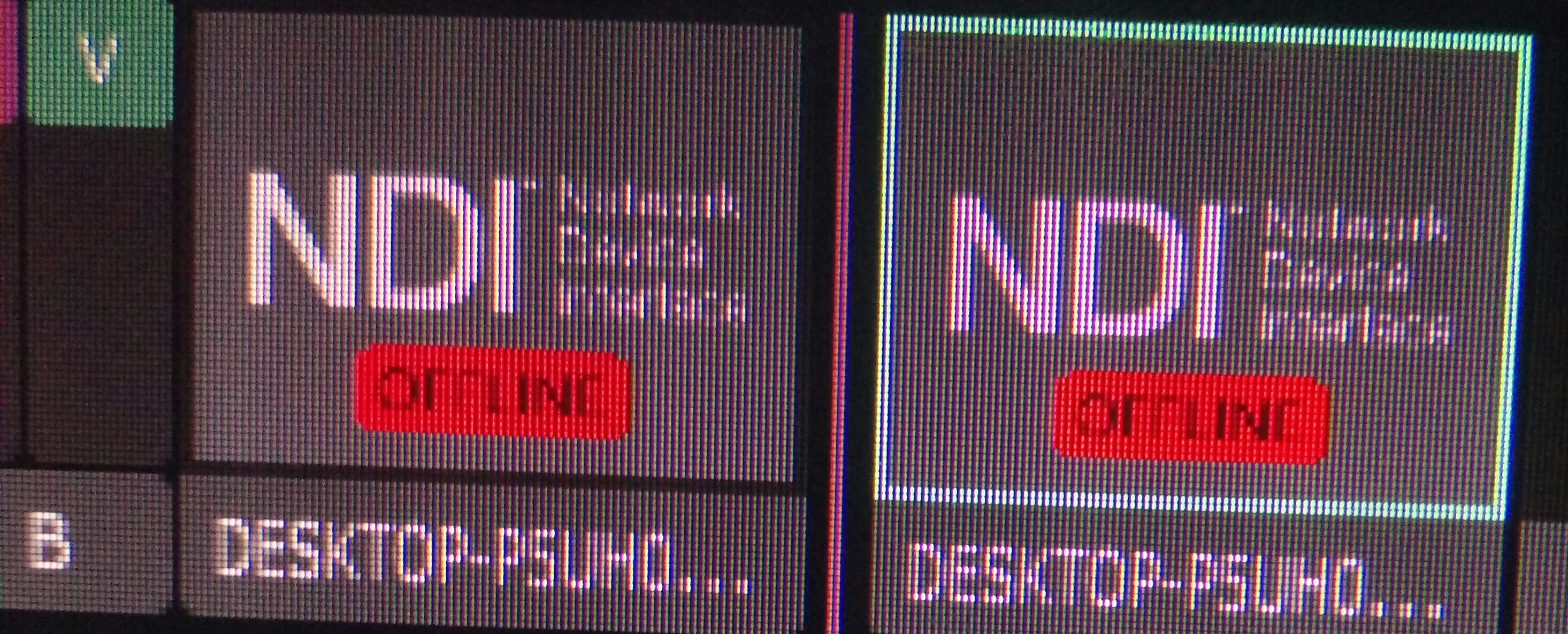

Hi all,
This is the first time to use NDI for capturing screen from laptop
I'm tried many methods but i think i made mistakes with connections
All i need is screen capturing from laptop
I have instaled NDI tools in my own PC
Also installed the on the laptop too
I have connected my own PC and the laptop to the network switch
On my PC runing the NDI Scan Converter
On the laptop runing NDI Virtual input
But the problem is : i found the NDI server offline (photo attached)
So please help me to resolve this problem
Maybe need to configure ip address or something else
Can anyone please explain how to capturing screen from laptop
Thank you

Have a look at this support page how to start debugging NDI: https://resolume.com/support/en/syphonspout#ndi-gotchas

Zoltán wrote: Thu Jun 27, 2019 21:19 Have a look at this support page how to start debugging NDI: https://resolume.com/support/en/syphonspout#ndi-gotchas
Thanks Zoltán for your reply,
It working only when i turned the Firewall Off!
Not working and going to be offline when i turned Firewall on
So where's the problem here?
Thanks again for your support
Posts: 7088
Re: Using NDI for capturing screen from laptop
moha20106 wrote: Fri Jun 28, 2019 13:02 Not working and going to be offline when i turned Firewall on
I'd guess, the firewall is blocking the NDI packets.
