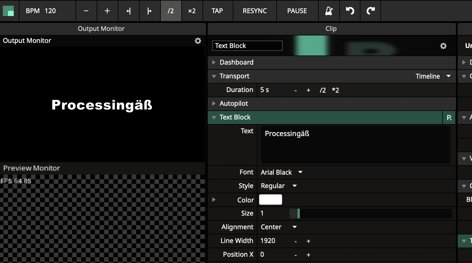

I just gave this a code and it seems to work just fine here. This what my Processing code looks like.
Code: Select all
  OscMessage myMessage = new OscMessage("/composition/selectedclip/video/source/blocktextgenerator/text/params/lines");
  myMessage.add("Processingäß");
  oscP5.send(myMessage, myRemoteLocation);

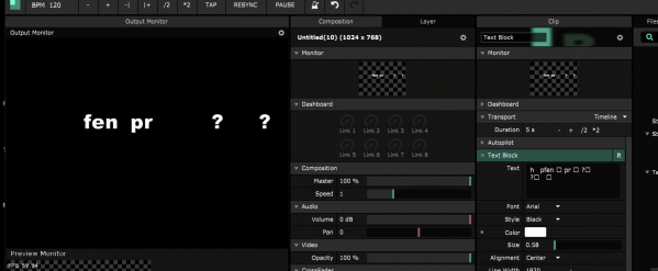

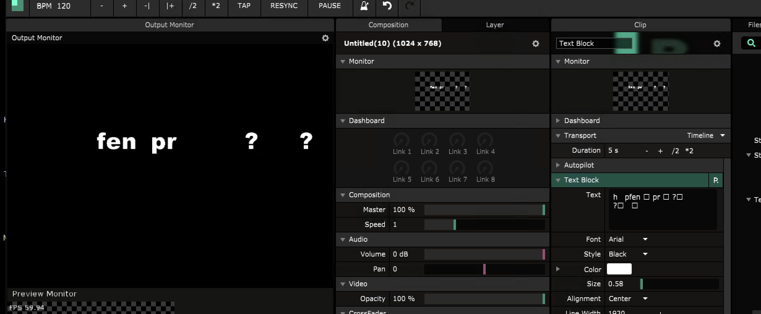

I've installed processing on windows, and it seems it can't send the characters properly.

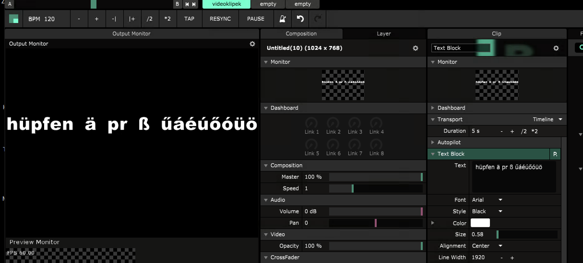

Running the same code in processing on mac to the windows Resolume instance, I get the correct letters.

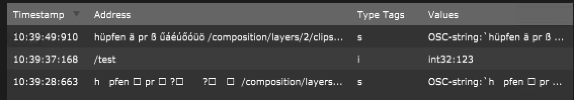

If I try to send the characters as address, it's also not showing correctly.
I'm leaning towards this being an issue in processing. Sending from Processing to processing, I also don't get the correct characters. Sending from Resolume to Resolume works fine.
