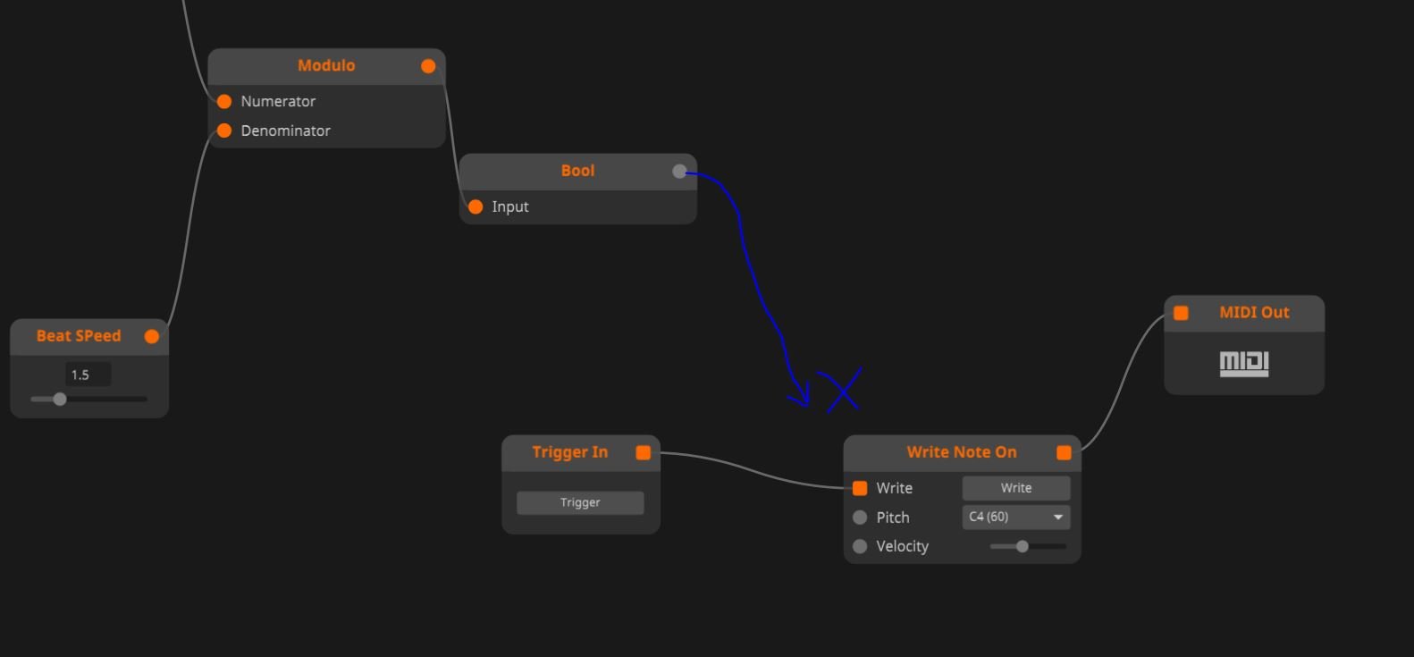

I have a generator that counts up and is MOD of an input. This generates a TRUE ever so often, kind of like an oscillator. I have tried everything possible, but can not connect it to the trigger of a MIDI WRITE module.
Is the TRIGGER input of the MIDI NOTE and CC WRITE modules locked to only accept a users CLICK?

Insert an OnChange node there, that's the one to go from Signal (cirlce) to Event (rectangle)

Zoltán wrote: Thu Jun 10, 2021 07:57 Insert an OnChange node there, that's the one to go from Signal (cirlce) to Event (rectangle)
Bloody legend! Thanks!

Signals will compute every frame, events will only happen when they get triggered and could even be triggered multiple times in one frame.
