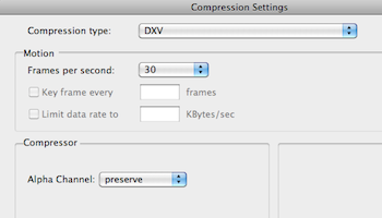

Hello,
I'm seeing an issue with After Effects CS6 and DXV codec. When I render a composition out as DXV on AE CS6 the transparency channel is not being preserved even though the options dialog box says it's enabled. I also have CS4 and when I try the same from there everything works fine.
Screen shot 2012-09-03 at 2.45.48 PM.png (16.46 KiB) Viewed 11414 times
While researching, I did read somewhere [though I can't find where I read this] that it might ultimately be an Adobe issue. But is there a work around? I would prefer to use CS6 to output DXV.

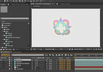

is the comp all animation or some video footage?

by lg3bass
Screen shot 2012-09-03 at 3.25.41 PM.png (123.19 KiB) Viewed 11409 times
-- CS6 project screenshot

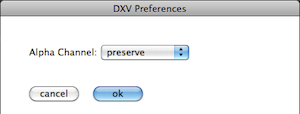

It's all animation from Maya as either tga or psd frames. In CS6 Despite me setting the "Preserve Trans" in the codex settings it still doesn't render it. Basically, instead of a transparent bg. It comes in as black.
I just did another test with CS4 and it works in there! in CS4 the codec options are within the AE modal window as opposed to another separate modal window in CS6.

working fine for me. make sure you have »RGB+Alpha« selected in After Effects. It doesn't change this entry automatically.

by lg3bass
Ahhh!
Thank you. that works! RGB+Alpha is the ticket.
