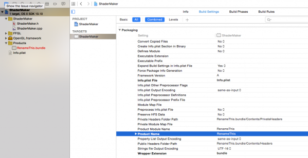

This is great, thanks for sharing. I've had success compiling plugins using the Mac OSX build, however Resolume does not acknowledge it in the Effects list if you change the name of the FFGL plugin. Works fine if you leave the name as default: ShaderMaker.bundle.
Any other Mac users had success with renaming? It would be nice to have more than one Shadertoy FFGL plugin available in the Effects list to create a deck full of these. Hoping it's just some newbie error on my end.

Just to be clear. Are you also changing both the ID and Name in "PluginInfo" within "ShaderMaker.cpp"?

Yes, I am. There was a workaround posted that involves saving the same file in different folders which works if anyone else is having this issue and wants to start bulding a set.

Posts: 5185
Re: FreeframeGL ShaderLoader

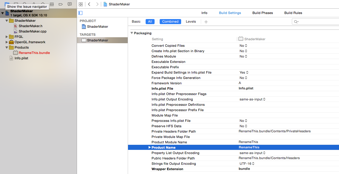

I don't think you can get away with just renaming the .bundle file like that.
When renaming Product Name in the Target Build Settings before building, things seem to go okay for me.

That's good to know, thanks Joris. The readme mentions just renaming the file itself which is what caused some confusion. Will definitely try that.
Update: Worked great!
