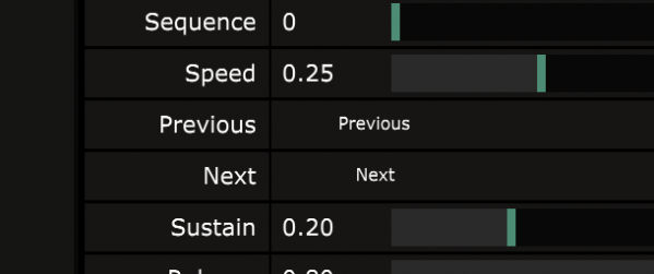

The definition is used by the host to decide what type of UI element to show.
You can use CFreeFrameGLPlugin::SetFloatParameter to handle pretty much every type aside from FF_PARAM_TEXT. For FF_TYPE_EVENT, the float argument will be 0.0 or 1.0 depending on the button's state.
As far as I know, there's never been specific handlers for params other than text. I suppose you could put in a pull request adding your own specifc SetEventParameter function, but that is for smarter people than myself.
Posts: 5185
Re: ShaderLoader plugin
Yeah, I just double checked the old repo on Sourceforge and it also does a basic cast to float for any param that is not FF_PARAM_TEXT.
Like I said, I use FF_PARAM_EVENT for two of my plugins. Both work as expected on 64 bit. I don't think FF_PARAM_EVENT is the cause of your problem.
