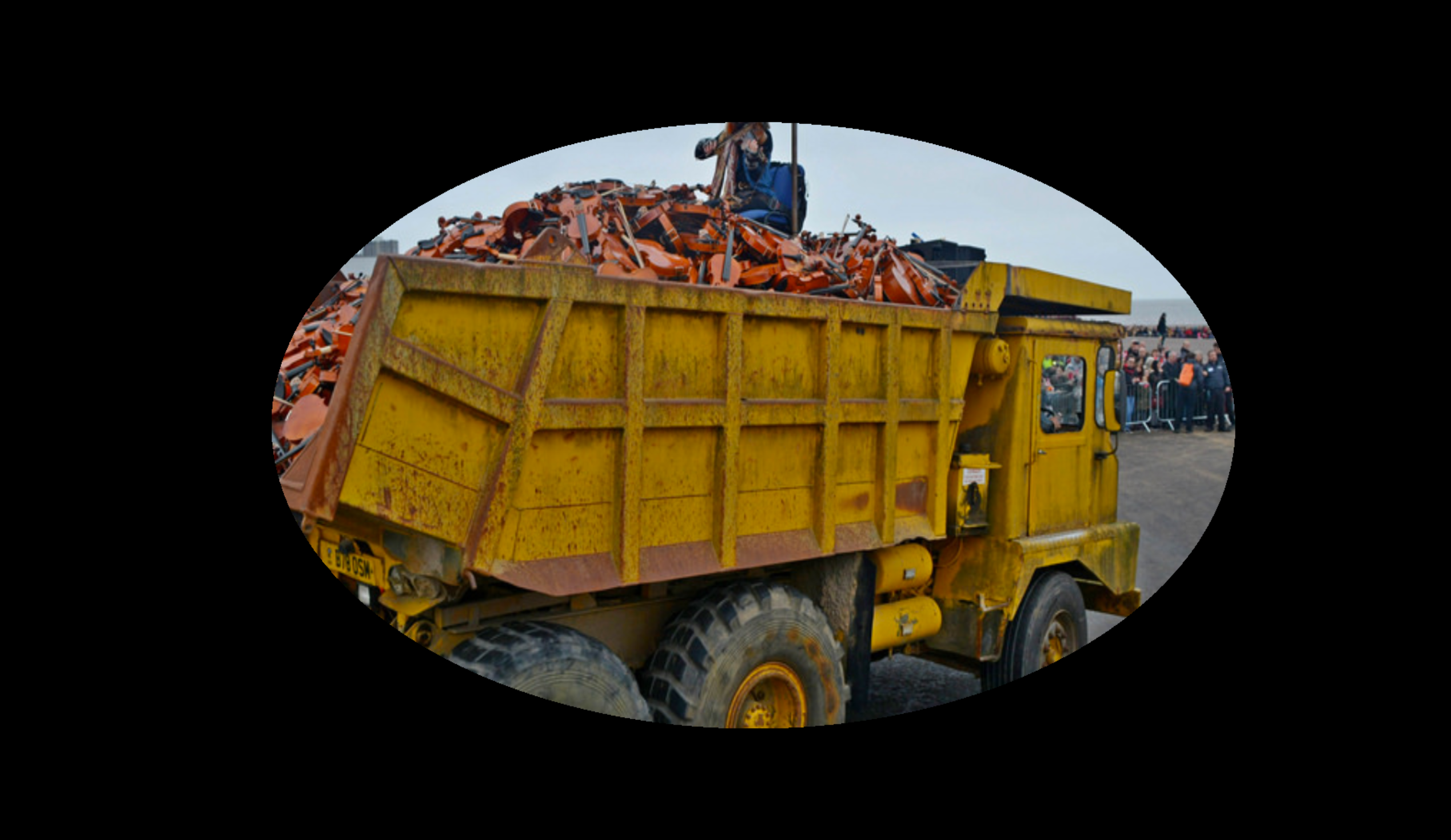

This is the result if I'm using 1920x1080 composition...
To calculate the distance from the circle center in the shader I am using the function "distance":
Code: Select all
float dist = distance(gl_TexCoord[0].st, vec2(x, y));

Update: I was able to pass the screen aspect ratio in ProcessOpenGL function. There is a "Texture" variable which has Height and Width parameters. I then passed the ratio of these two numbers as another shader uniform parameter. This works, UNTIL i change the screen resolution, or output to another screen... i don't get it... is ProcessOpenGL called only once while initialising the plugin?
