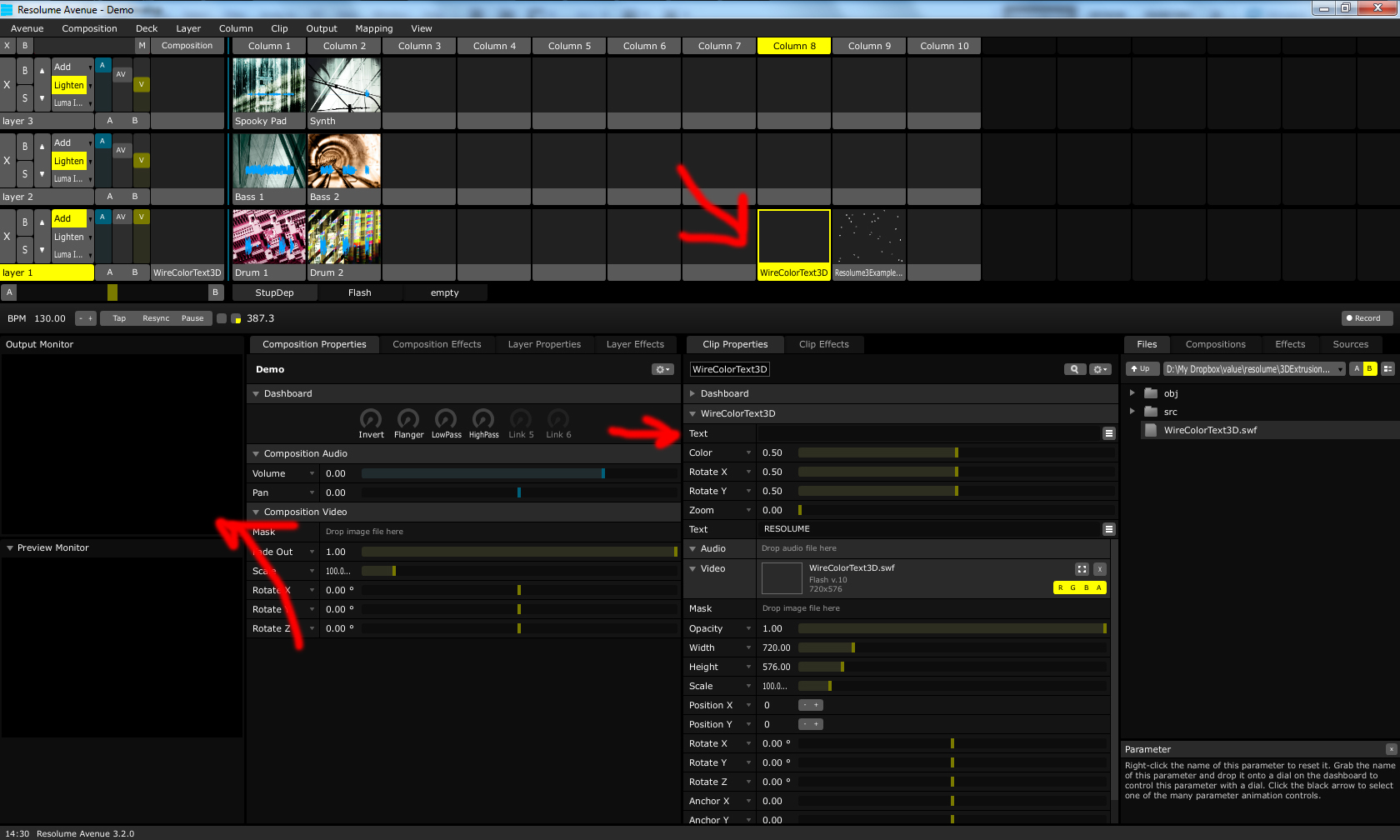

Resolume 3.2.0 / Flash Player 10.1 r52
Before I install Flash Professional CS5 I has older version of Flasp Player and my swf has worked.
After install Flasp Player version has changed to 10.1 r52 and my swf doesn't work anymore :o
And some extra text field appears.

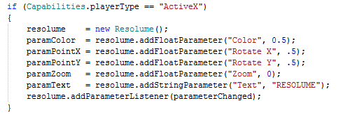

Part of my source code:
SWF File:
WireColorText3D.zip
(253.27 KiB) Downloaded 2427 times
Some useful screenshots below:
How can I fix this bug ?

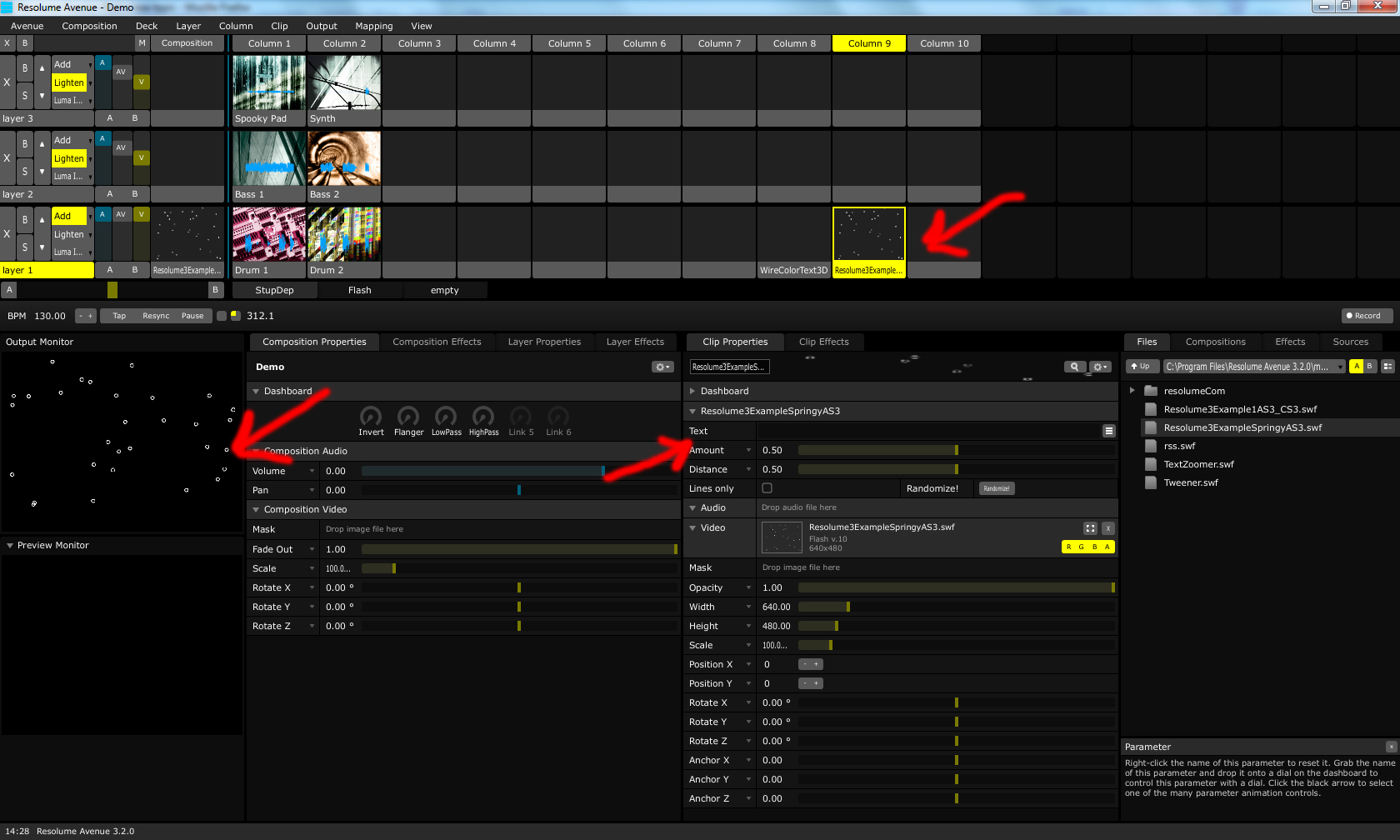

i also have problems with flash since i installed cs5. some of my flash files work perfect like they used to, but some flash v.5 files won't start playing (they just show one frame which doesn't move) when i start them however the timeline is running as always. when opening with flash player they play normal. any ideas?
in attachment one file which doesn't work:
three_amigos.rar
flash_example
(6.15 KiB) Downloaded 2041 times
edit: and i also tried to update to 10.1.53 and it won't help...

krybin wrote: Part of my source code:
Didn't know you could test on ActiveX existed. Good to know because the flash files are just not working when you play them in the normal flash player.
We will have a more in depth test to see what we can do to fix the CS5 issues. Like said before each new version of Flash introduces new problems. It just a lot of work to fix something that was working before.
