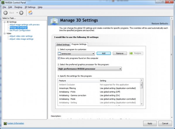

How do you do this? i got a new LP with a GTX 765 GPU and Intel 4700Mq, but the log says it is using Intel HD 4600. How do i get resolume to use the GTX?

Hmm well I checked my laptops log and it uses the NVS 3100M, weird because my laptop has worse playback than my friends laptop, the laptops are identical in hardware except I have an SSD in my laptop and my friend doesn't. I guess i've been wrong about this the whole time. Anyway my log says this.
---Info main OpenGL renderer---
Vendor : NVIDIA Corporation
Model: NVS 3100M/PCIe/SSE2
OpenGL version: 3.3.0
OpenGL version short: 3.3
OpenGL shader language version: 3.30 NVIDIA via Cg compiler
As to how to configure Resolume to tell it to use the more powerful graphics card, take a look at the screenshot below. Also it helps to make sure you have the latest NVIDIA drivers as you'll get the best performance out of using those.
