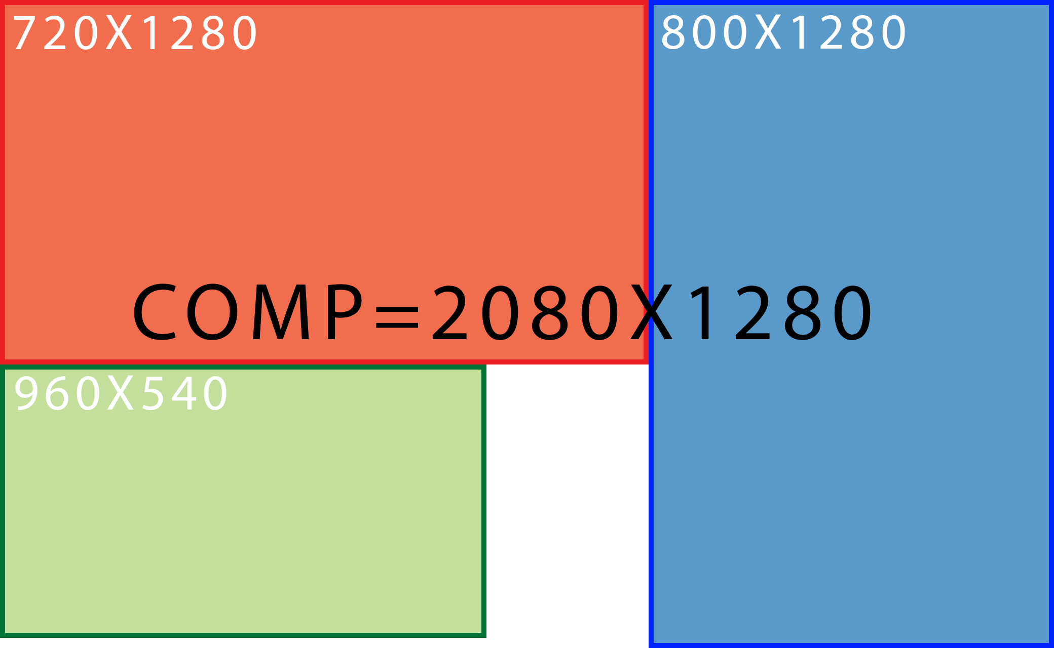

Re: 3 outputs with different sizes
He2neg wrote:I would suggest you use the highest resolution of your three outputs.
Or you can create a composition that is combination of the three outputs and use Slice Transform with the slices that correspond to your various displays to position your content on the final output. Here is an quick example:

moha20106
Posts: 77
Joined: Thu Dec 20, 2018 07:56
Post by moha20106 »
Oaktown wrote:
Tue Jan 01, 2019 21:56
Or you can create a composition that is combination of the three outputs and use Slice Transform with the slices that correspond to your various displays to position your content on the final output. Here is an quick example:2080x1280.png
Thanks dear for your reply,
With your method, i have to assign each display to one layer
Example :
The red display will use layer 1 only
The blue will use layer 2only...etc
Am i right?

He2neg
Posts: 764
Location: Berlin, Germany
Post by He2neg »
You can use the SliceTransform to quickly assign the layers to the slice you need them.
you also can use SliceTransform on the Comp or the Group Lvl... so you will be more flexible.
moha20106 wrote:With your method, i have to assign each display to one layer
Example :
Am i right?
You can use layers but I personally use groups for my various screens.
