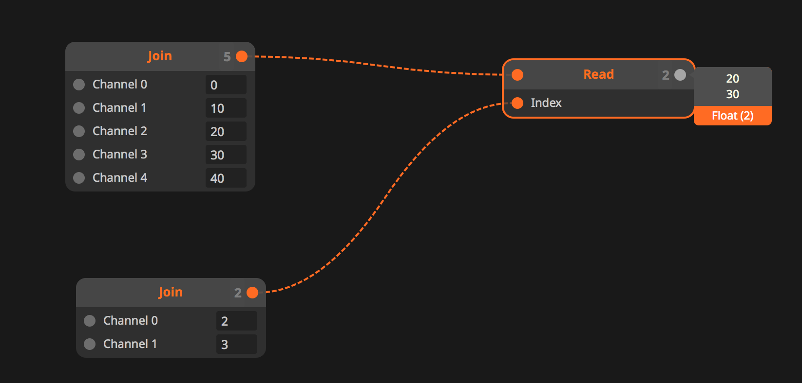

Thank you so much for wire its really awesome. I was wondering if it is possible to show a example how to select a certain slice. I had no problem following the outline example. Wanted to make a chaser was wondering how. Array or Index please let us know how :)

If you're making your Wire patch, using the Read node should work.
You can also have multiple indexes read at once.

The read node worked like a charm, thank you.
Could you eleborade on multiple indexes with the read node :)
Posts: 7108
Re: example select slice
This should explain it pretty good I hope
