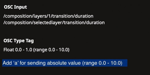

Often I want clips to auto-crossfade for more than 10 seconds for use in theater.
It would be great if I could use the layer transition duration for this instead of putting clips in separate layers and animating the layer opacity using OSC.
It it was for me:
- maximum of 3600 seconds transition time
- the duration fader remains to control max 10 seconds, however it would be great if a greater value can be entered manually in the Layers tab AND a value can be send by OSC using:
"/composition/layers/1/transition/duration a 15" (for a 15 second fade)

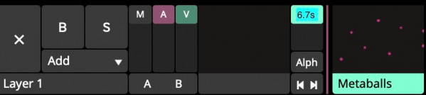

extra: - a small countdown in seconds at the location of the layer transition fader to know its running
One extra note:
It would be great for all the newbie OSC freaks to have a reminder that sending an absolute value is possible.
Much gratitude! :)

Litte more info: really 5 minutes (300) seconds would be more than enough, but sometimes designers or directors really really want fades that long. I can assure you. In case of 5 minutes I would love to program it using OSC. However many many man times I'm using 15, 30 or 60 seconds as a transition and that's why I ask. If changing the max value to 60 seconds maximum is easier, I would be super happy as well!

Have u tried this ? It does require your clips to be long enough so they don't get looped while transitioning.
Put clip 1 in layer 1 / column 1 , put clip 2 in layer 2 column 1.
On clip 1 , go to the clip opacity parameter, click the gear icon left of it and choose "Clip position"
Now the opacity value will go from 0 to 100% over the duration of the clip.
Click the gear icon again, enable Enveloppe , and reverse the enveloppe line so it goes from 100 to 0%
Do the same for clip 2 but let the enveloppe be from 0-100%
If you now start the clips by pressing on the column 1 tab, it should work, and u can use the enveloppes to fine tune the duration and curve of transition.
That said, it would be nice to be able to add a custom big number in the layer transition parameter (havent tried if it can yet to be fair). Just leave the slider next the layer transport controls on 10s pls so i don't accidentally scroll over it & put it on 2000sec :)
