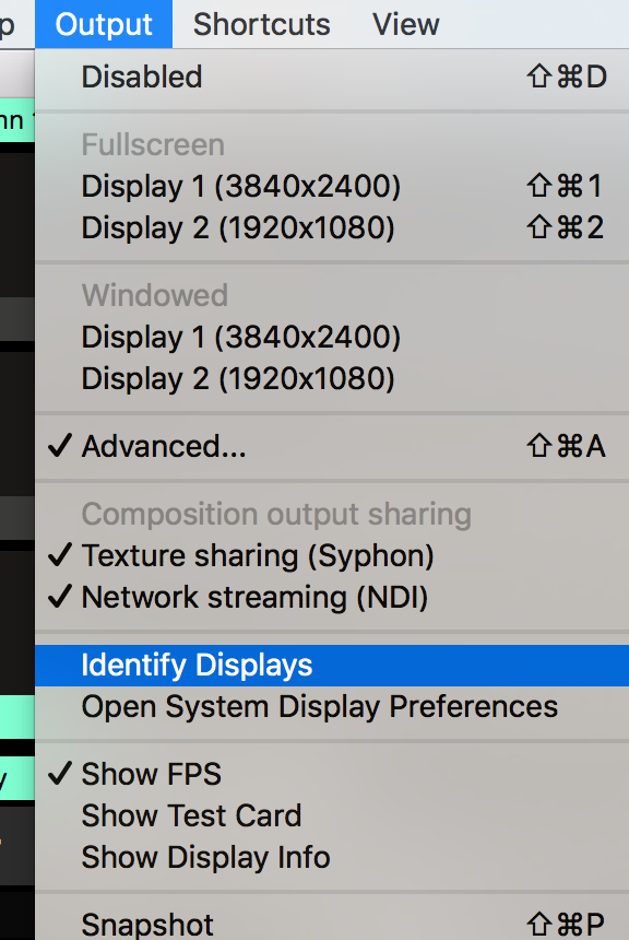

Or better yet (for me lol), maybe just have a feature under the "Identify Slices" param in ASS that says "Identify Screens" and this will send out the standard Windows style "1,2,3,4" overlay on the screen without actually taking over the screens so we know what output 1,2,3,4 is. Or is there a way to hardcode Resolume's screen 1,2,3,4 to always match Windows screens 1,2,3,4? Then we could just use Windows to find this out, but with Dedicated GPU's on a machine with only 4 output's I've seen Resolume show Screen 9 before? lol
You mean like this? https://resolume.com/support/en/output- ... y-displays
It works best if the outputs are disabled.

Ahhh! I tried that back in like V5 or V6 but I always had outputs assigned when I tried it, this makes so much more sense now lol.
Well this gets me what I need :) I can live with this
Thanks for the help
