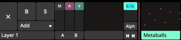

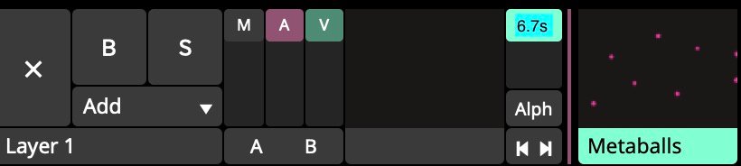

Often I want clips to auto-crossfade for more than 10 seconds for use in theater.
It would be great if I could use the layer transition duration for this instead of putting clips in separate layers and animating the layer opacity using OSC.
It it was for me:
- maximum of 3600 seconds transition time

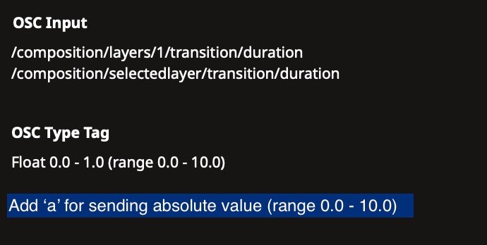

- the duration fader remains to control max 10 seconds, however it would be great if a greater value can be entered manually in the Layers tab AND a value can be send by OSC using:
"/composition/layers/1/transition/duration a 15" (for a 15 second fade)
extra: - a small countdown in seconds at the location of the layer transition fader to know its running

It would be great for all the newbie OSC freaks to have a reminder that sending an absolute value is possible.

Litte more info: really 5 minutes (300) seconds would be more than enough, but sometimes designers or directors really really want fades that long. I can assure you. In case of 5 minutes I would love to program it using OSC. However many many man times I'm using 15, 30 or 60 seconds as a transition and that's why I ask. If changing the max value to 60 seconds maximum is easier, I would be super happy as well!

A little background information: I use Qlab (runs only on MacOS) to program Resolume. Qlab is like a cue-master program where we can 'cue' everything until the smallest detail with the use of OSC messages, including OSC-fade messages. So I'll use Qlab to animate the transparency fader of a clip, for instance.
