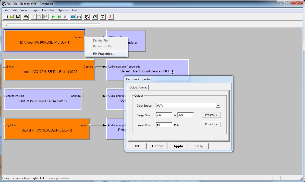

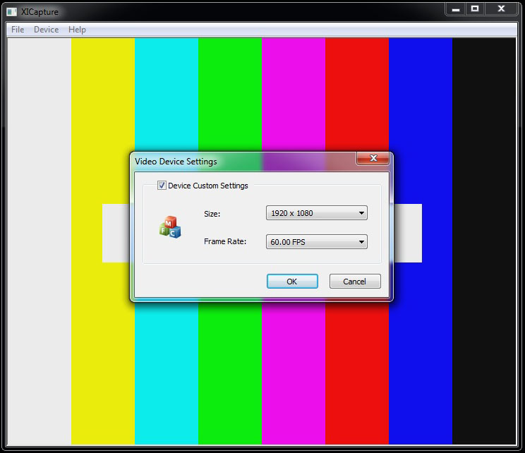

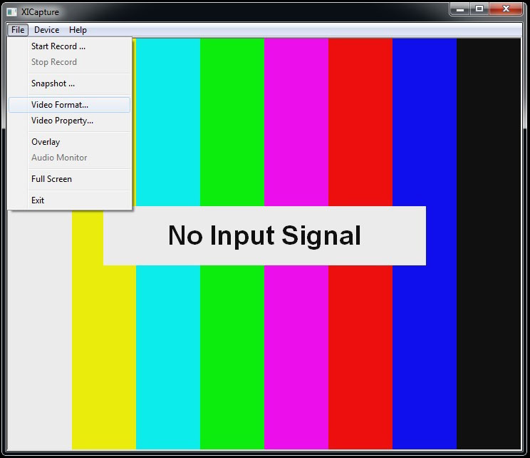

I can capture up to 1920x1080p 60fps content smoothly (SDI, HDMI, DVI, VGA and also Component, S-Video, Composite on lower resolutions) using the manufacturer supplied Capture Express software.

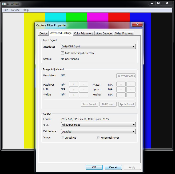

I noticed the 'video format' setting of the capture software seems to use 25.00 fps as default which gives a stuttering stream, but when set to 60fps I get a smooth image.

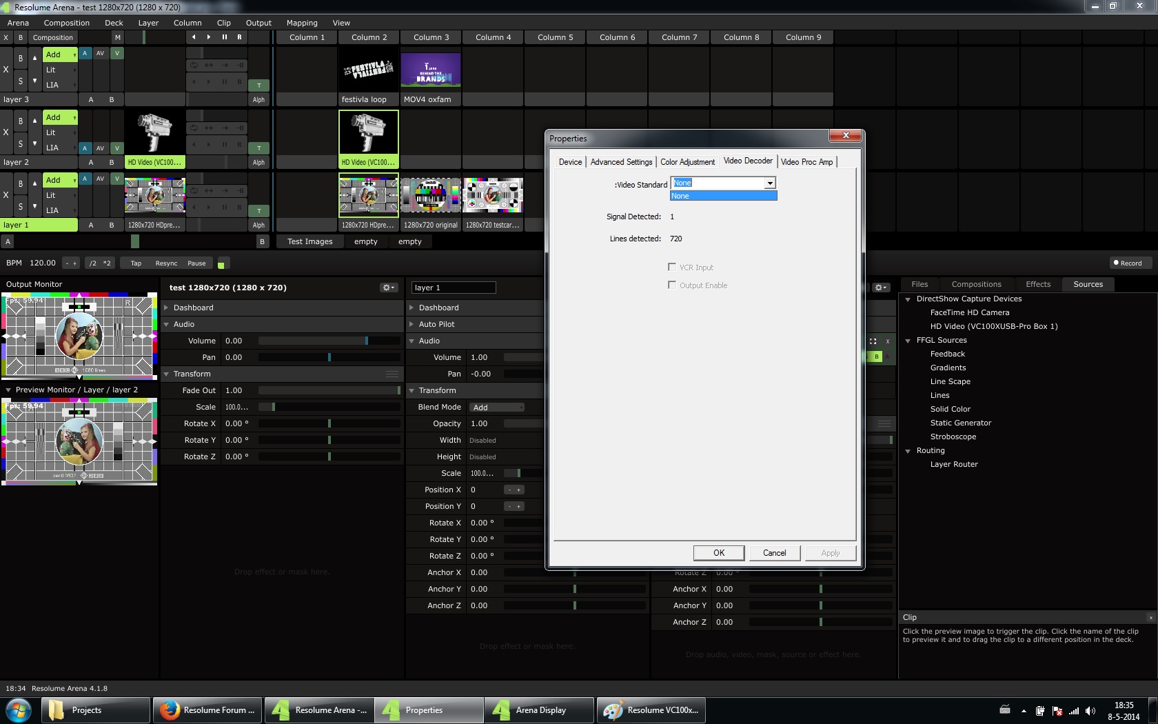

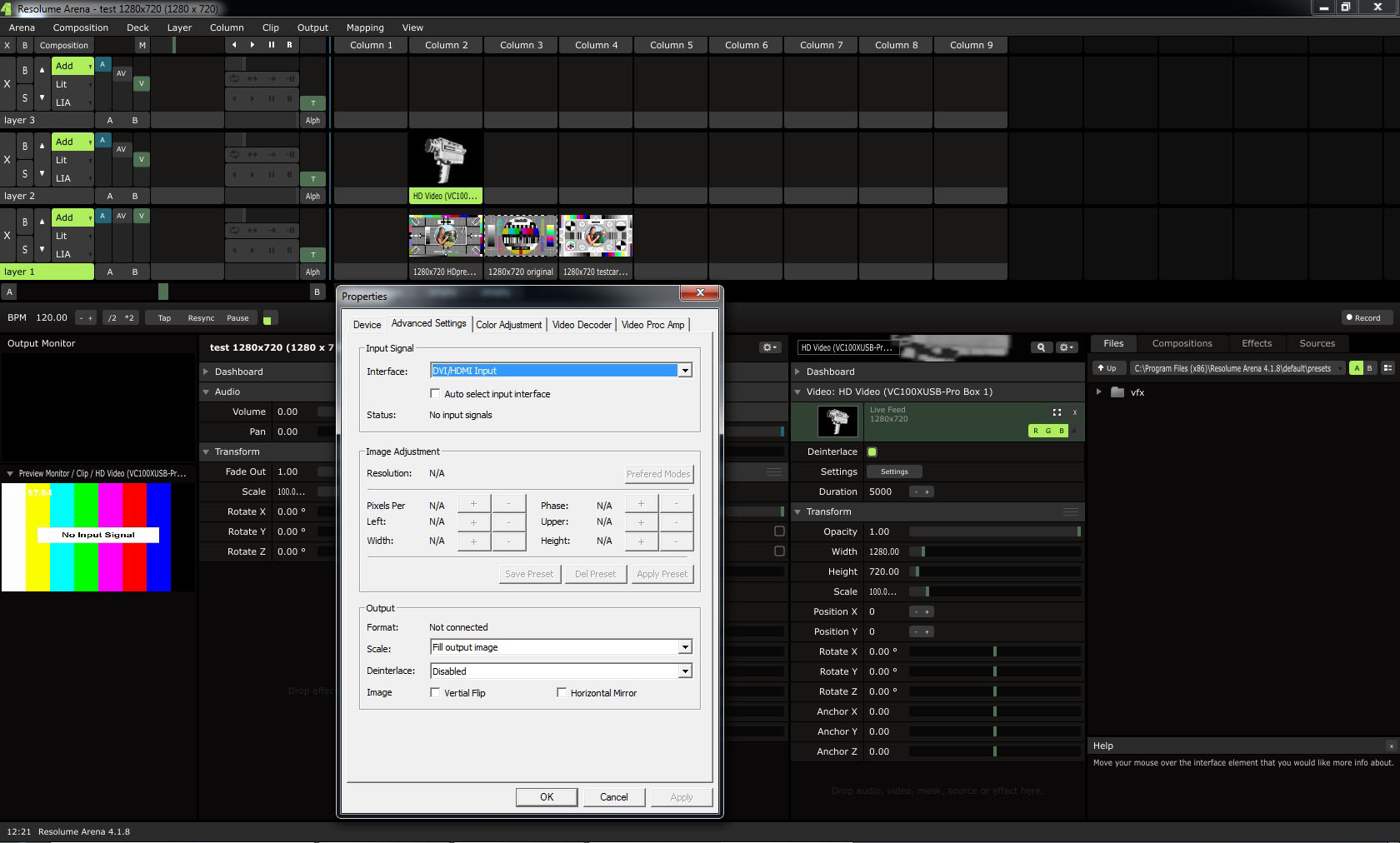

My problem is, in Resolume I can not enter these 'video format' settings. It only allows access to the 'video property' settings.
Setting the frame rate to 60pfs in the capture software seems to reset to default (25fps) upon exiting that program and opening Resolume. I need to be able to set the capture stream to 60 fps or else I get stuttering, jagging video stream
So ultimately, my question is; How do I set my capture device setting to 60fps in Resolume?
