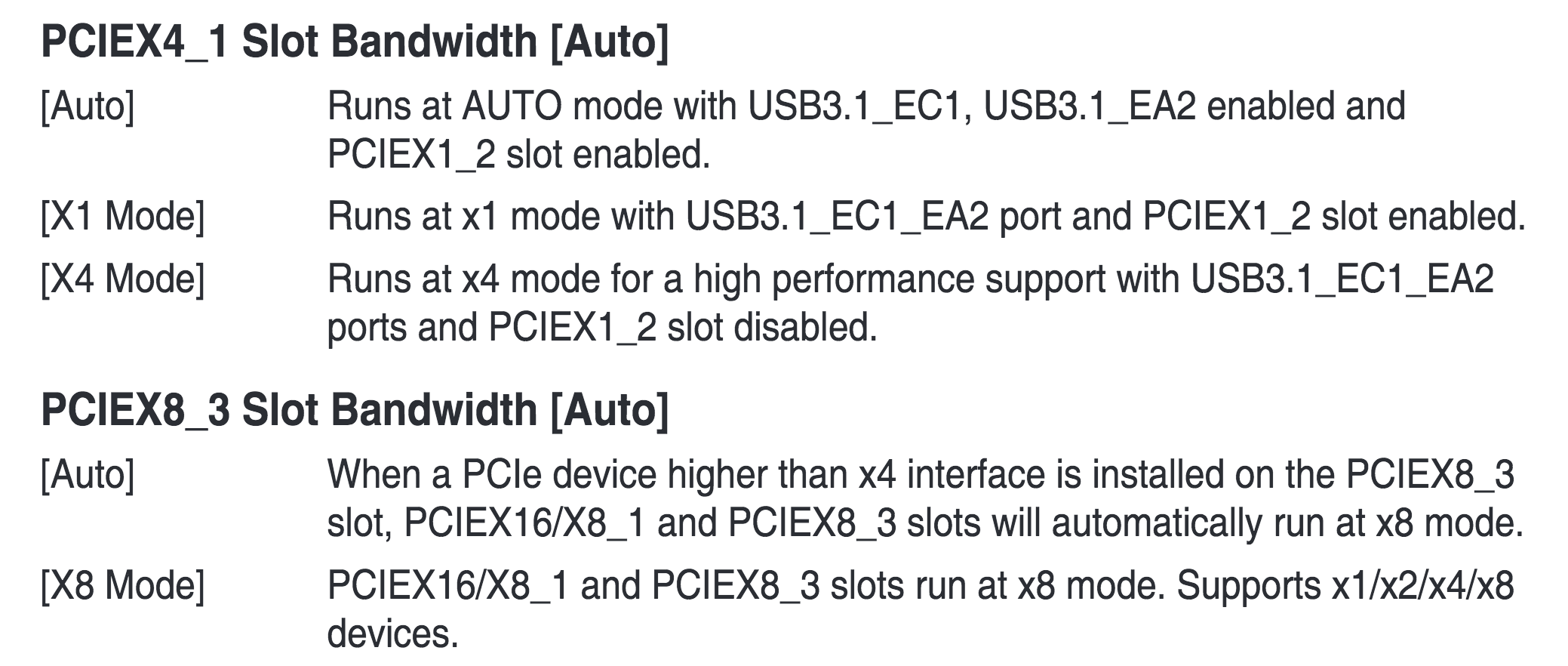

Not sure why the last configuration is slow but as a note, if you put your BM on #6, #1 will run at 8x instead of 16x. Also if you have USB 3.1 enabled, #3 will run at 1x instead of 4x.
Check out your Onboard Devices Configuration for both PCIEX4_1 Slot Bandwidth and PCIEX8_3 Slot Bandwidth are set correctly.
Try running your GTX1080 on #1 and your BM Duo 2 card on #3 in [X4 mode]?

Thanks Oaktown, much appreciated. The servers just went out on shows, but when they get back we're going to continue testing. Will keep all posted about our finds. Thank you!
