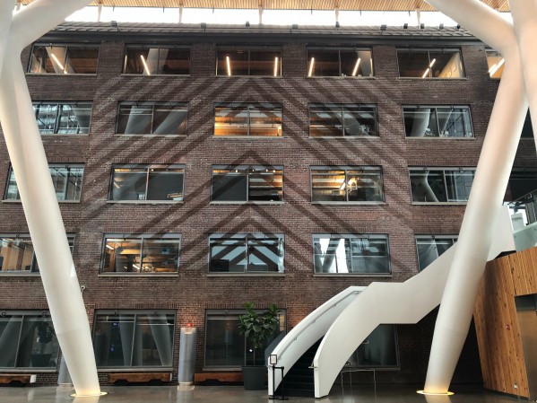

I have an update on this project.
First of all let me apologize because it will be a long and confuse explanation 🙏🏼🙏🏼🙏🏼 Forgive me please.
The total height and width would be 617”x440”.
The maximum throw distance is 60’ (there’s a wall).
The client wants the surface to be approx. minimum 617” x 370”.
This surface is red dark brick and 9 windows.
We will be able to put some white light cardboard attached to the windows from the inside only.
I’ll use a truss at 14’ (is the same starting point of the projection height).
Show time will be 10pm and we will turn off most of the light.
The projectors are Christie Boxer 4K 30,000.
I’ll have three of them, and I was thinking to use two for one main composition (screen1) using a 25 active HDMI 4k 4:4:4. To a black magic converter HDMI to SDI 4K (Blackmagic Design Mini Converter HDMI to SDI 4K (CONVMBHS24K) by Blackmagic Design https://www.amazon.ca/dp/B00VZ2GOSY/ref ... eBb1W4NWA9)
So I can feed the two boxer via SDI) and we’ll use the third projector 3840x2160 (Screen2) pointing towards the ceiling (light wood).
We have a storyboard and the idea is to have one composition pixels 3605 X 2160 24fps and ceiling screen is 3840x2160. 24fps.
Now, the client was pushing to cover all but I’m not sure it’s a great idea blending two 4K for 70”.
I’ve suggested to double up the lumens instead.
The throw distance initially was at the wall 65’ - 5’ for the projector itself.
But from this distance using a zoom 1.13-1:31 would not cover the minimum area (even if the the test I made it was with this lens inclined about 25*degrees with vertical off set. I’m assuming on a truss would lose inclination and dimensions there fore I’m opting to go for a 0.90 fixed Lens and get at 53’ of distance for a 16:9 - 617”x370” for a Comp 3605 pixels x 2160p. Masking the remaining to 3840 of max width.
Again so sorry if I’m confused.
I believe having a brighter image and 70” less it’s better than having to blend two projectors toes in portrait with some zoom weird outcome and extra blend.
I hope the more experts can give me an opinion and any recommendation.

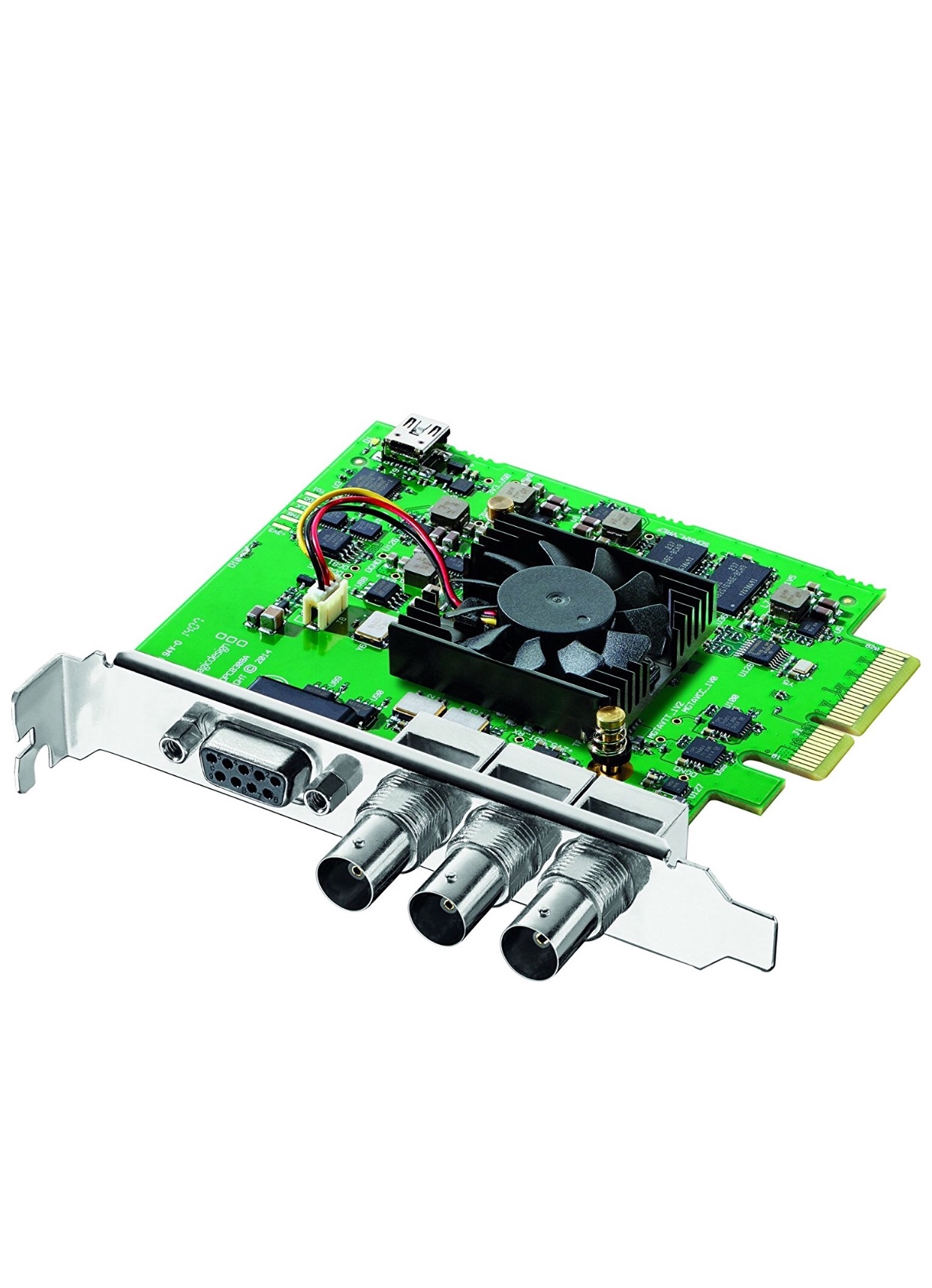

Woukd this be the perfect fit for thus show... without going true datapath and HDMI ?
Blackmagic Decklink SDI 4K.
If I plug 1 sdi to one boxer and loop out via sdi seeing as 1 3840x2160p one screen and if I plug the second sdi will I see another 4K screen ?
Sorry guys but I never worked with sdi :(
Mostly display port and HDMI.

Re: Christie Boxer 4K, HD base T and Ethernet switch
The red brick is going to absorb your lumens like crazy so I think it's a good move! If we assume a gain of .35, (2) 30K projectors will give you about 14fL which could work well if it's dark night!
I would go test the brightness with a small projector to get a sense of what you're dealing with (a 5K projecting a 15.5'W x 8.75'H image would be roughly the same).
I would mount the projector stack on a 25ft equipment lift to have more flexibility.
Don't forget that a fixed lens has to be positioned at image center so if you can, and it seems like you have enough throw distance, I would use the 1.13~1.31:1 which would give you some lens shift options. It will be a lot easier to blend your stack.
EDIT: It looks like the 0.9:1 lens has some lens shift (offset: V: ±45%, H: ±15%). The 1.13~1.31:1 (offset: V: ±60%, H: 25%)
My $0.02 as always!
If you go the SDI route, get two cards so each projector can have it's own signal for redundancy! That will also give you the ability to fine tune each projector in your media server.
I read somewhere that the black magic deck link will result in some frames delay, how will affect my show?
Are you doing Imag?
Will the HDMI with two sdi out would be a better choice?
My preferred approach would be HDBaseT especially if the Boxers you're renting have the HDBaseT card. If not, just get (2) RX/TX units and if you go that route, make sure you use solid core CAT6A ethernet cables.
Would you recommend to use two OUT SDI into the boxer 4K and then loop two boxer SDI out into the stacked boxer on top?
No I would recommend using two independent HDMI to SDI 4K adapter or PCIe card out of your server.
In regards of the Blackmagic, are you saying to plug both SDI output to the 2 in of the boxer?
No, if you use one HDMI to SDI 4K adapter, you'll want to plug one SDI cable into each projector.
Keep in mind that 6G-SDI single cable is not quite as easy to extend at 12G-SDI quad cable so be mindful of the type of cables you use and the length of your runs.
When did you say blend and stack in the previous you meant to double up the lumens like I think I should go?
The only way for me to have the same image on the boxer is to send HDMI to 2 SDI, 1 to one projector and the second to the second projector.
