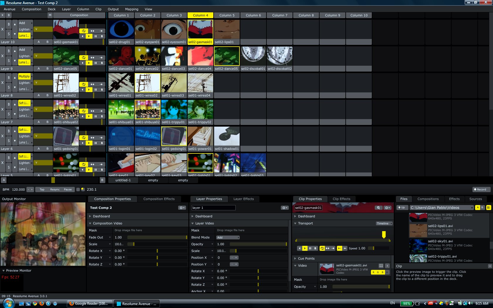

I just put in two Corsair 256GB SSDs in my VJ machine (for another application). It is a laptop with Core 2 Duo at 2.9Ghz.
With all the clips playing off one of the drives, I can playback 8 layers at 640 x 480 at 60fps. By 10 layers It drops down slightly to 55fps. CPU utilization hovers around 44%. (By comparison, with the older drive I started to see frame rates dropping as soon as 4 layers were playing.)
With clips playing off both drives, I have reached up 14 layers at 640 x 480 at 60fps. CPU utilization is not even at 55%. Beyond this I can not tell what is happening with fps because the fps counter has fallen off the bottom of the screen. (Bart & Edwin: please make it possible to arbitrarily resize the layer vs control areas... the little resize handle appears, but doesn't seem to do anything...
I would have to say this is the single most impactful upgrade I have ever made to a computer in terms of performance.
Screen shot of Resolume with 10 layers running
resolume 10 layers.jpg (309.78 KiB) Viewed 18049 times
