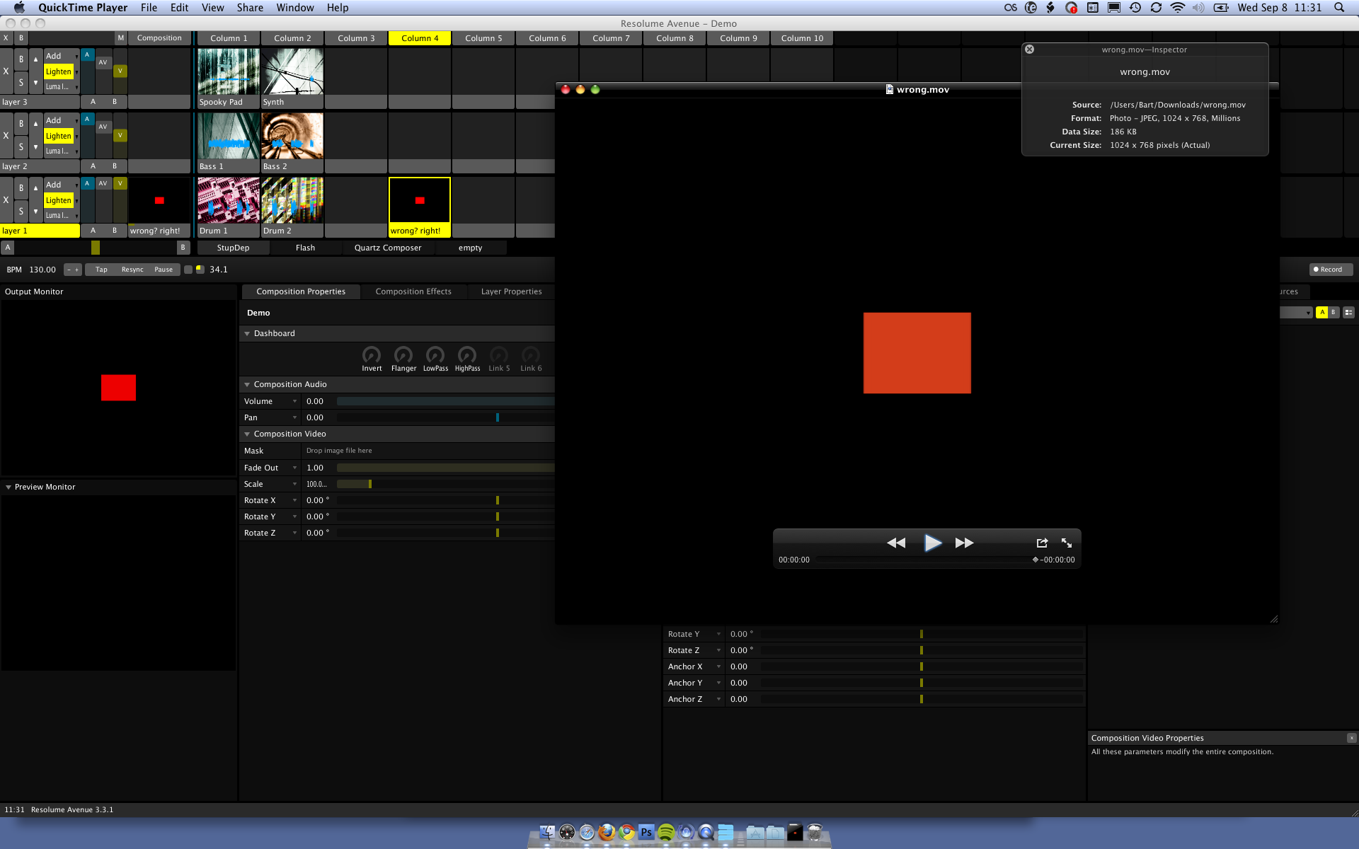

Posts: 2240
Re: decay between original and recorded file
Works fine for me, see the screenshot, but perhaps I'm not 100% sure what the problem is?
Screen shot 2010-09-08 at 11.31.18 AM.png (281.83 KiB) Viewed 9548 times
Tschoepler
Posts: 467
Joined: Fri Mar 13, 2009 04:26
Post by Tschoepler »
This obviously is not a square. Make a screenshot of the clip's parameters. To me this looks as if you don't have the clip's width and height set to the same value: (1024*0,15)x(768*0,15)= 153,6x115,2 which is about the size of the red block in your sample.
