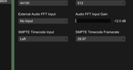

But the program has only one input SMPTE. While both sides playing together mix. Resolume two SMPTE signal gets mixed right and left. Need something to separate fed both of them to know what software to use to run the clip
- Attachments
- record.PNG (11.62 KiB) Viewed 20659 times

I would imagine you would need a timecode generator(hardware), there is software available....it is costly.
Re: SMPTE Setup
You have two signals and only one input...
Kind of the same problems DJ's have... - Two CD-players and only one soundsystem....
Mayby you are looking for a mixer?
Re: SMPTE Setup
Hahaha funny
) And what happens while mixing the crossfader is in the middle and hear the fed both of them together?
Re: SMPTE Setup
Well actually, fading would not work for SMPTE as far as i know.
But having two timecodes i beleive you have a couple of options right now:
1. Switch between the timecodes on the way in to your computer (maybe with a mixer or something else?)
2. Get a second computer and then use a videomixer and mix the outgoing video instead?
Any more options maybe?
