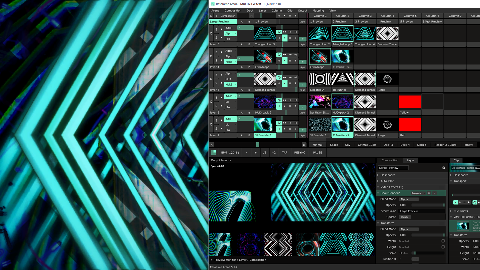

Above we see layer previews, as well as the composition preview, in the Output Monitor window. The "Preview" window is minimised to have the most space available for my arrangement.

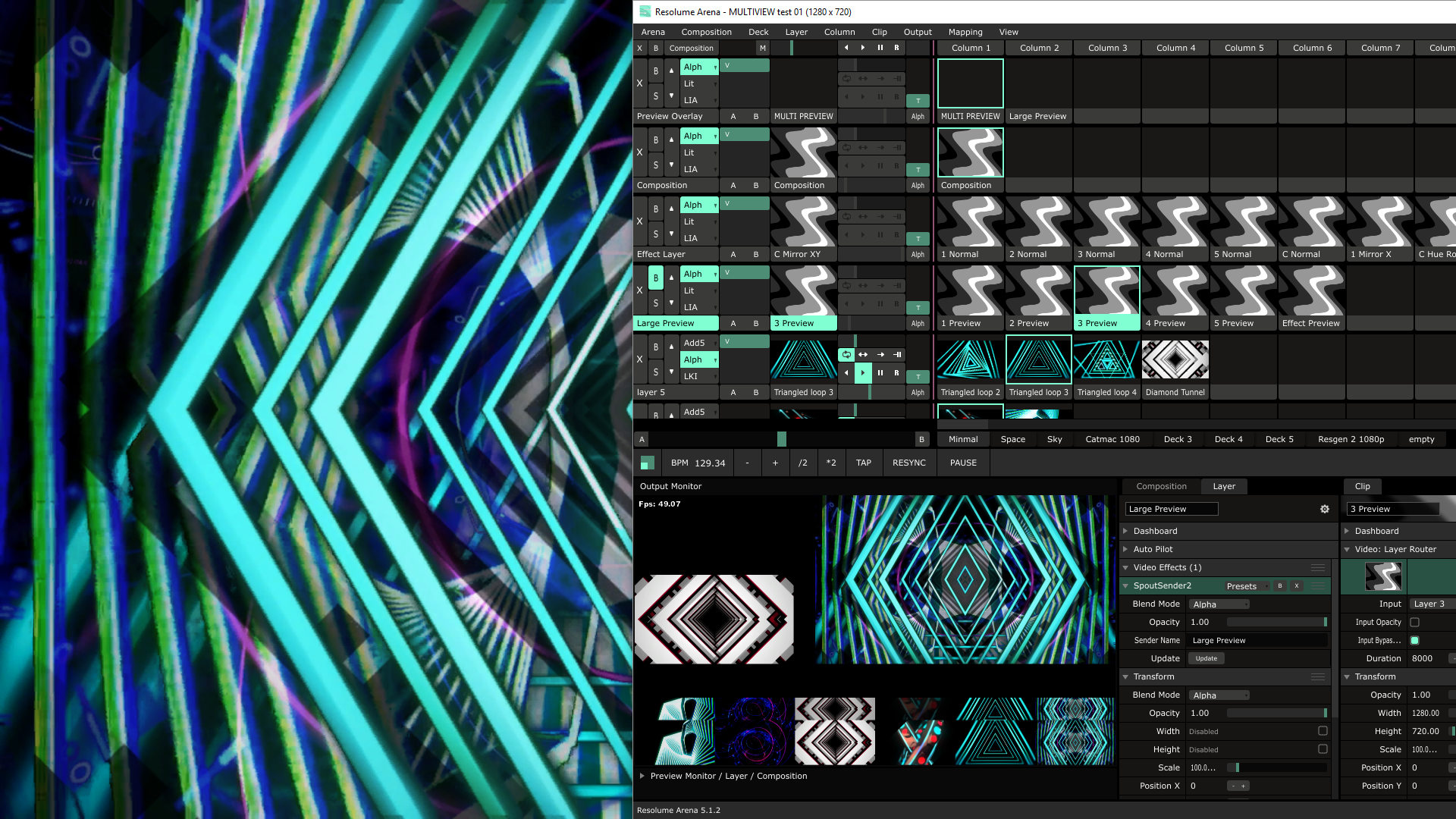

Above is detail showing that I have a layer dedicated to the "Larger Preview" slice. It consists of layer routers that pull the contents of the first 5 layers (with video content) as well as my "Effects" layer which, unusually, is actually higher up in the layer stack - since my screenshots are already this way and I haven't tested it in another order, that's the way it is for now. It should be able to work moved up two layers, between the "Composition" layer router layer and the "Preview Overlay" layer.

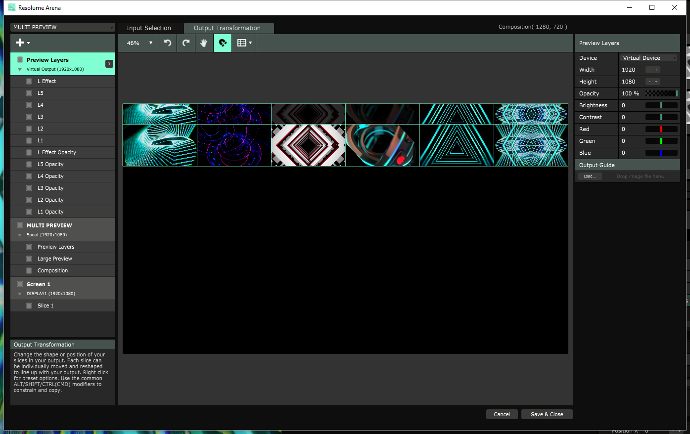

Above is shown the Virtual Device where I arrange just the 6 "content" layers for previewing. The bottom row has slices that ignore the layer Bypass and Opacity settings. The top row has slices that do not ignore those settings. This way I can see what content is in the layer as well as how strongly it is being applied to the mix.

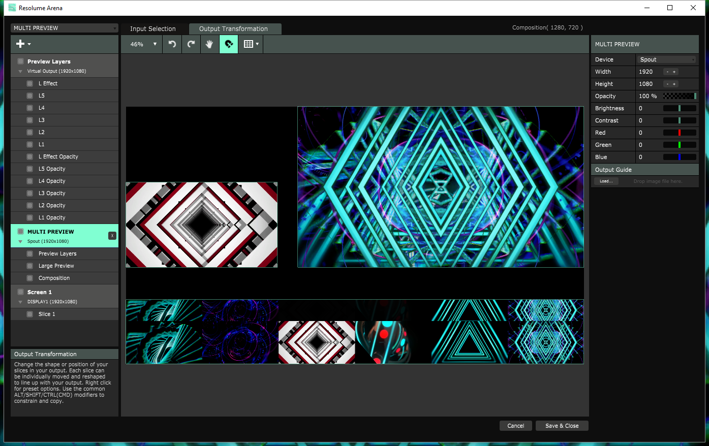

Above is the Advanced Output arrangement for what I want to appear in my Output Monitor window in the main Arena UI. The Preview Layers slice is sourced from the Preview Layers Virtual Device (cool!) and the "Larger Preview" (top left) slice input is a separate layer in the composition with Layer Routers used to make a 6x1 switch.
The "Composition" (top right) slice input is also a layer with a layer router used to grab the composition contents PRIOR TO the layer which overlays this multi preview arrangement.
The output device for this screen is Spout (shows up in Spout source listings containing the screen name, "MULTI PREVIEW").

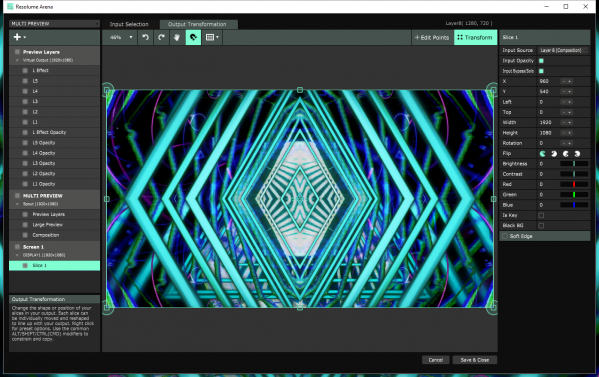

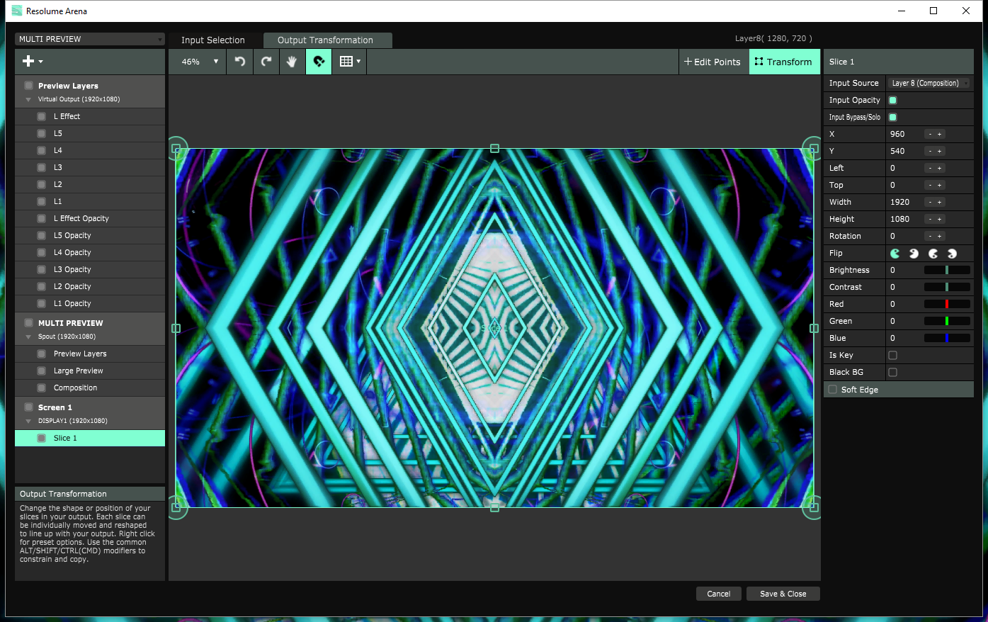

Multi Preview 02c - AdvOut - Main output slice uses Composition layer router layert.png
Above we see a basic "main output" screen, which, like the MULTI PREVIEW screen, has the input source set to the layer router pulling the composition prior to the multi preview overlay.
I almost never use the master fader control for Resolume. Instead I use a Brightness & Contrast effect on whatever layer(s) I'm pulling my main output slice(s) from in Advanced Output. I use a slider for Brightness and a rotary knob for contrast.
