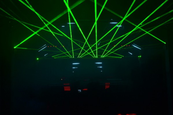

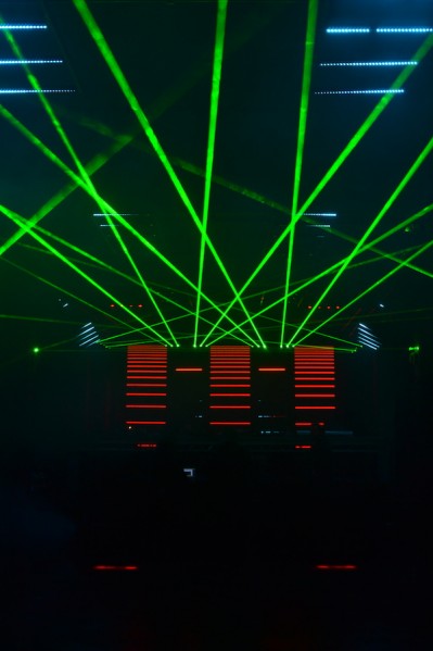

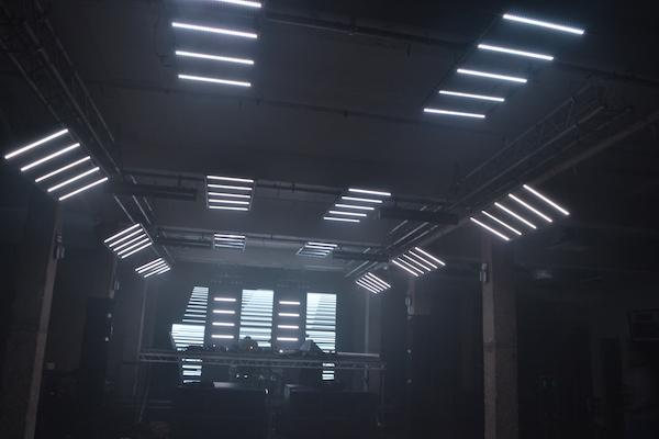

In the video we’re using 70x RGB pixel battens, a 12mm LED screen, 24x green point lasers and 4x RGB sweeper beam moving head lights. Everything runs from inside the new Resolume Arena 5 software. We’re running the LED screen straight on DVI, while all the other fixtures are controlled using a Showjockey 16way Art-Net to DMX box on 16 lumiverses.
We create animation sequences, for e.g simple flashing boxes, and they are used to control the lighting fixtures. DMX works in values of 0 – 255. So, to translate that in to video, black is 0 and full brightness is 255, and that’s how we work with the ranges of each lighting fixture. The moving heads sweep beam lights only have one axis but split in to two sections per light, which is fairly simple to control in theory but was quite difficult to find a working solution without using more layers. For this, we used a gradient source so we have control of the brightness on 2 sides of a solid layer. We mapped the DMX value for the lights tilting to either side of this gradient, which meant we can use Resolume’s automation controls to sync in the movement, or map the movement to a fader on our midi controllers.
The lasers work on a matrix that any value over 250 switches them on, and the pixel battens act like a low resolution video screen so we can extend the content from the LED screen out over the heads of the audience.

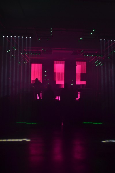

The latest Resolume 5.0 release is the backbone of the production we do for The Hydra. We’ve invested a lot in equipment, displays and lighting fixtures over the last year with the idea that we can control most elements of a show live, with all the lighting and video elements working together in synchronicity, in perfect time with Resolume’s BPM tracker and all running from a single laptop. It’s a fairly new and unique approach to controlling fixtures, using an animated composition as the triggers. We simply design our show layouts in 3D, and export image masks to work from and animate on top of. In Resolume we then map all our fixtures in the advanced output of Arena, sending our DMX over Art-Net and the video via DVI.
