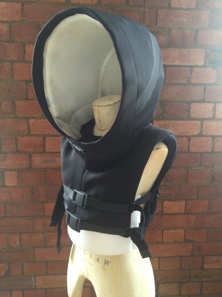

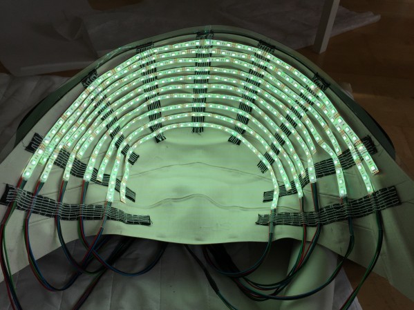

Tell us about the trio’s super cool headgear. They change color, strobe, are dimmable. How?!
The led suits are custom designed and built by Élodie Laurent and are basically 3 generic led parcans and have similar functionality.
They are connected to the lighting desk just as the rest of the lighting rig and are driven using the same system.
Fun fact: These are the only three lights we bring with us so the Outer Edges show is extremely tour-able.

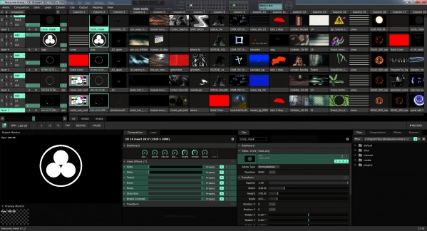

Talk to us about some features of Resolume that you think are handy, and would advice people out there to explore.
Resolume was a big part of the design process in this show. Using it almost as a small little After Effects, we stacked up effects until we reached our preferred end result. We triggered scalings, rotations, effects and opacity using the full OSC control option Resolume offers. This makes it super easy to create spot on synchronized shows. With a minimal amount of pre - production.
This in combination with the really powerful mapping options makes it an ideal tool to build our shows on!
