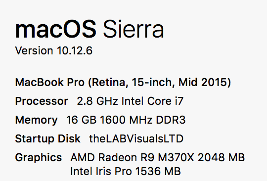

Just installed update via auto-updater and unable to open Resolume Arena 6.0.2.
Bombs out each time attempted.
Have rebooted.
Still bombs.
#sadface
Screenshot 2017-12-12 11.15.19.png (54.93 KiB) Viewed 14844 times
