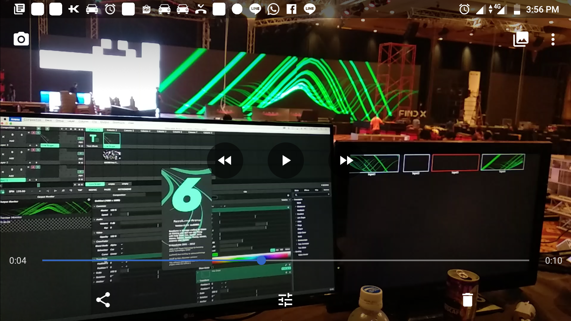

Recorded video:
Tearing resolume 6:
https://youtu.be/G3BC9Kmsjxc

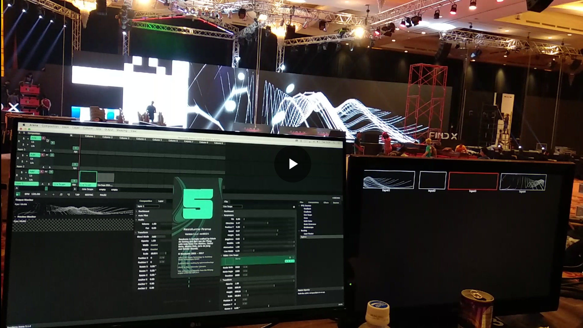

No tearing resolume 5:
https://youtu.be/iU4OtwvB6-I
Resolume 6
Resolume 6
Resolume 5
Resolume 5
