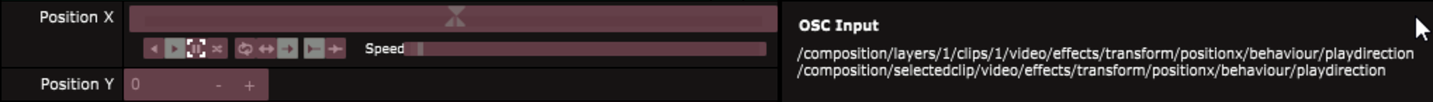

What you could do would be to set the position parameter to timeline.
Set the timeline to paused and one shot, set the range to your start and end position values, and set the speed to something low that matches the time you need the move to happen.
Then when your Cue comes, you'd send a single OSC message to set the parameter play direction to forwards.
If you need more interactive control, you'll have to set the positions constantly over the 4 seconds with different positions.
