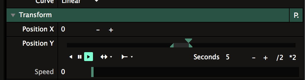

Thanks Zoltan, envelopes awesome, however a sledgehammer to crack a nut. Currently all I want to do is to get to a lower value. I am just moving the Y position of a very long picture scrolling it through the frame and .01 is moving it too fast. I need it at .005 or even slower, .001!. An extra digit of decimal place would be great. cheers John
Posts: 7106
Re: Allow slower speeds on speed control
If you hold down ALT while moving the slider, you can adjust in finer increments.
Also entering a value smaller than 0.01 will not be treated as 0.
Limiting the position range to something usable can also help a lot ;)
Speed set manually to 0.001 works for me too, moves about a pixel on the y in 20 seconds with range set to -1080 -> 1080

You can also use the speed at 1, and set the param duration directly to the exact time you'd like it to travel from one end to the other ;)
Try changing the 5 seconds to a day or a week worth of seconds..
