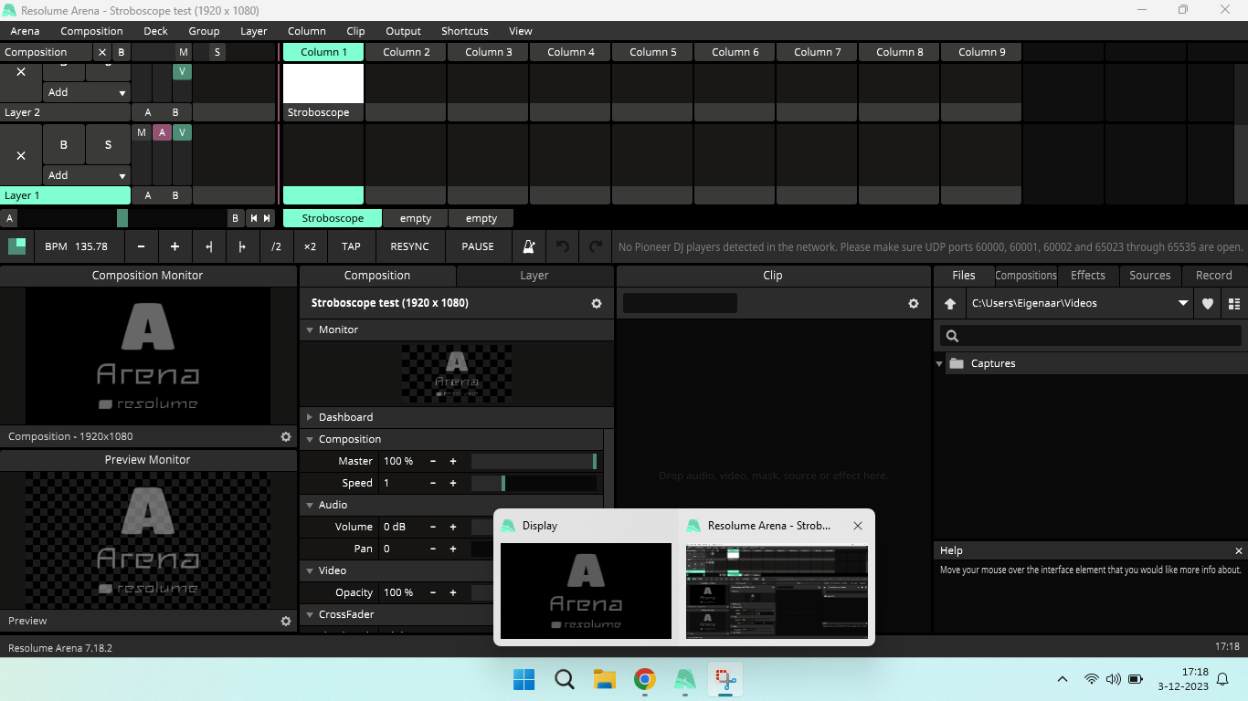

I can't close the display mode when this is active. the regular closing button does not work here.
^ Could you elaborate a bit more on this one? Could you attach a screenshot or video?
]Thank you for the response!
I made a screenshot for what I meant with the display mode. Your first thought might be to just close it by clikking on the 'x' in the top right corner. However this doesn't work. It seems that the display mode is somehow bugged.
Maybe buying the license is worth it if the price is not too high :)
ceecrb1
Posts: 66
Joined: Thu Aug 19, 2021 23:58
Location: Valencia, Spain.
Re: New to Resolume - A few questions
Post by ceecrb1 »
CTRL SHIFT D
Or from the top menu bar, output- disabled
