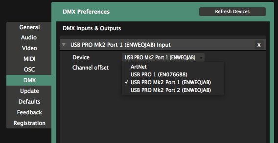

My apologies, I should have included that I am able to get 2 universes out of Resolume by creating 2 Lumiverses in the advanced output and creating 2 DMX outputs in the preferences window, just not with this Enttec device.
I have output 2 universes by using the 1 output available from the Enttec Mk2 and 1 output over Artnet using a different Enttec device (ODE). When I create more than 1 output of DMX in the preferences tab, only port 1 of the Mk2 shows as an option for any of the outputs. Picked up the Mk2 to output 2 universes and not carry the ODE.

You're currently stuck in development limbo between us, Enttec and Apple.
Here's the story. Please bear with me.
Long ago, we used Apple's own USB drivers to connect to Enttec devices. This was confusing to a lot of users, because Enttec themselves said to use a different driver set. So we changed it. We were in sync. Things were good. It was a happy time.
Then, around the release of Mavericks. Apple decided to only allow their own set of drivers, and disable all apps that use different drivers. This included Enttec. Enttec didn't know what to do for the longest time. Even their own website still says the USB Pro MK1 and MK2 will not work on El Capitan. But, when you download Pro-Manager, it says their devices are now working with Apple's own drivers on OSX.
For us, this means we have to go back to our old code. This is going to take a little while.
In the meantime, I suggest to contact Enttec and ask them how to use their devices on OSX with software that uses their old driver set. If they get back to you, please let us know as well. We have a very hard time getting support from them.
Sorry about this. I'm afraid I can't make it any easier for you and this is currently how it is.

The good news is that on El Capitan, Enttec's suggestion to use Terminal to enable the old drivers seems to work for me. I can see the old Mk1 and both ports on the Mk2 after running it.
sudo kextunload -b com.apple.driver.AppleUSBFTDI
Edit 27/6/2016: Don't do this anymore! Just update to El Capitan and Arena 5.0.2 and you'll be fine. Sudo'ing your way around things will probably break your computer.
