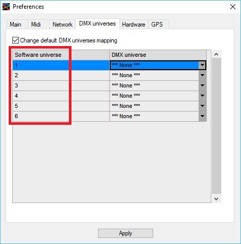

On second look, you may be right. The way SX works is you have to have 1 DMX interface (any of 3) to get 1 DMX universe and that also unlocks 1 Artnet Universe (1024 chan total).
I was thinking those drop downs were to route a universe # to the correct interface. Meaning if Resolume likes Universe 0 or possibly 1, then I would route #1 to my Ethernet adapter. Then route Universe #2, to my D512 DMX box. I will test tonight when I get off work. Just trying to knock this out on my breaks.
Guess I jumped the gun as I did not see a universe "0". With no box, I can't see anything there (if universe or interface). Not bringing anything to work to test is my fault.. Getting close to an answer though, then I will publish something for those who want to use SX with Resolume.
SX can be complicated (especially building fixture profiles, which I did above) but It has allot of power. I don't see myself controlling Resolume this way but I know SX and will help where I can.

Odd thing is, that universe page still shows "**Nothing**" with my interface connected and multiple universes enabled. It also just remaps the default universe mapping. So maybe I can make universe 1 into 2 or vice versa. Either way, I want to do it right the first time without remapping. Which brings me to the next..
The other issue, once all your fixtures are in universe 1, you have to wipe the universe 1 to then add them to universe 2. Then re import your scenes, which gives you an error. So you have to manually select the fixtures that you moved to universe 2. Not impossible, but very clunky. I will feed that back to them, but they are working on their next major version. So new features are going to be far off.

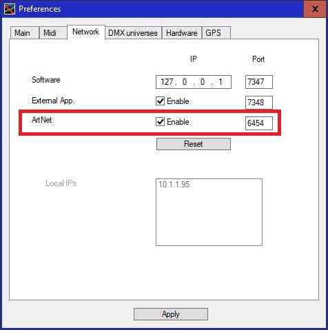

So I am feeling very comfortable with the controls. I even did some work with SX on other light fixtures to remind myself of the work flow. But I can't get SX to control Resolume at all yet.
My real question is what do the numbers in the Resolume config mean? 0 (zero) is not an option for a Universe in SX and Subnet is not an option at all in SX. Here are my Resolume settings. I have tried setting numbers here, 1s and 0s in each, all and combinations.
Here are some of the ShowExpress options. Artnet is enabled and I restarted SX.
SX Art Net enabled.JPG (43.75 KiB) Viewed 13351 times
