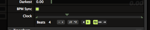

Gave FRMultiStrobe a whirl, and BPM Sync works fine.
You just need to animate the Clock parameter with BPM Sync. That's how the plugin knows what the BPM is doing.

It doesn't work for me unless I also match the interval to the beats (for strobing on the beat). Use the Interval number on the right that goes from 1 to 10 rather than the slider value. So 4 beats would need an interval of 4. If you have 4 beats with an interval of 2 it will strobe every second beat. Quite flexible really and if you adjust the in and out you can add a bit of swing to the flashing.
