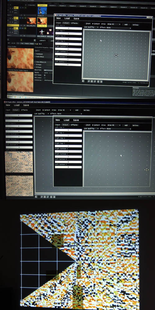

Hi Ivan,
Thanx for the beta version, however it crashes Resolume when the editor window is maximized and it also distorts and provides noise to the video outputting (see attached image), and it takes a while to regain one's controls again (tested the issue several times). Then I UNinstalled it and REinstalled it and the same issue occurred again (did not restart my PC however). PS: I was in OUTPUT mode when this issue occurred.
So then I UNinstalled it and REinstalled the previous version 1.1b and that works absolutely fine when the editor window is maximized and unmaximized several times.

Hi Ivan,
