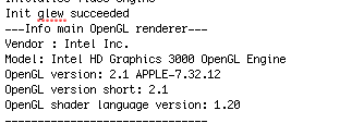

Becasue the output monitor is pretty much for your eyes only and you probably want it updated as fast as possible, we're not waiting for screen refreshes. So there is a possibility for tearing.
As long as it's good on the secondary output, I wouldn't stress out too much about it.

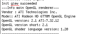

You could give a quick check in the log to see if Resolume is actually running with the proper GPU though.
Intel GPU ( Bad ):
Discrete GPU ( Good ):

arena runs on the Amd - so thats nice to know.
