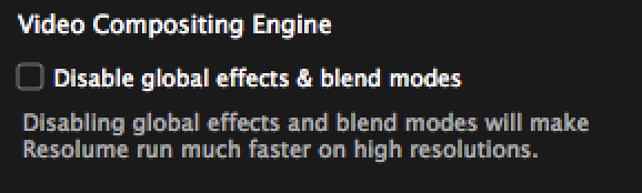

Re: resolume and yosemite
Posted: Mon Jan 05, 2015 16:31
by Oaktown
I was going to suggest you reinstall Arena so I'm glad that worked out for you.
One thing to keep in mind if it happens again is that under Preferences>Video, there is an option to disable/enable effect & blend modes so make sure it's unchecked:
Screen Shot 2015-01-05 at 7.29.18 AM.png (21.62 KiB) Viewed 6330 times
