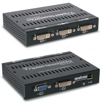

What you need is a device which can receive your signal and cut it into 3 separate pieces and then send each piece to its own physical output. If you are on the budget side I would recommend you a Matrox TripleHead2Go Digital Edition with DVI in/out. You can easily adapt from and to HDMI.
DONT use USB to HDMI/DVI what so ever devices!!!! They will not work!
You own a notebook with a gtx860m.... so I would guess your max. output resolution is 3840x2160 pixels NVIDIA SPECS.
You need 3 separate outputs... so 3840px/3 = 1280 px.
So every individual output of the Matrox TripleHead2Go Digital Edition can have 1280x720px.
Hope that answer helps you.
