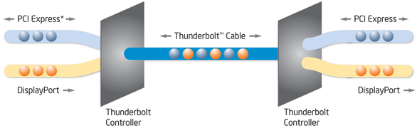

Wasko wrote:I know that resolume will recognize a Black Magic Mini Recorder (Displayport in my case), but I am unsure about this.
As a note, DisplayPort is an output not an input so your BMD Mini Recorder is actually using PCIe (input/ouptut) on your Thunderbolt port which is both DisplayPort and PCIe.

Does this mean that my Displayports work as a PCI-E port?
No but some motherboards can take a Thunderbolt adapter and you would connect your GPU to the TB adapter to combine DisplayPort and PCIe on the Thunderbolt pipeline.
