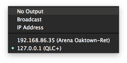

An Arena 6, are you sure you didn't set your DMX input to the same universe as your lumiverse?
Can you send a screenshot of your Artnetominator window?
When you open QLC+ and set your input to 127.0.0.1, does it show up as targetIP in your Arena 6 lumiverse? And do you see Arena when you check the Nodes Tree in QLC+? See pics below.
Screen Shot 2017-10-01 at 07.49.09.png (40.16 KiB) Viewed 15998 times

In R6 I can't get it to work. Everything looks as you wrote, Oaktown: in Resolume there is IP "127.0.0.1 (QLC+)" and in QLC+ I see Resolume's node, but QLC+ doesn't receive anything.
Oaktown, was it working for you? With Resolume sending and in QLC+ ArtNet-Input enabled and Passthrough actived, did you see faders moving?
EDIT: Well, it works if I select "Broadcast" in Resolume AND if I am in an actual network (i.e. WiFi) - but then the problem is again: I'll spam all IPs/receivers in the Network.

I don't think you can send to localhost with resolume 6.
In R6 you explicitly have to select the adapter, and I don't think that you can get back to localhost without active packet routing from a private IP.
