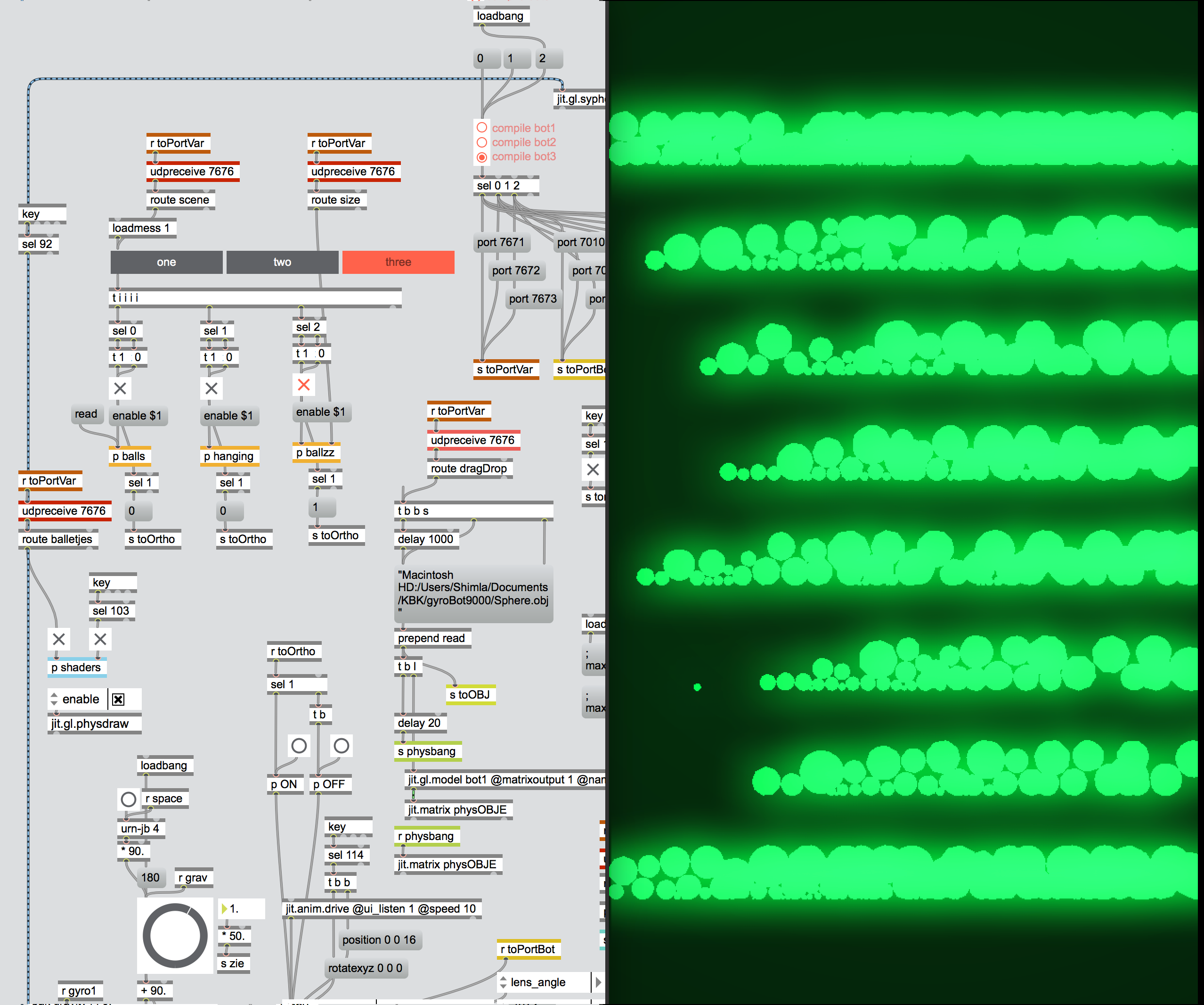

The arms are basically repurposed factory tools, and their motion is pre-programmed and triggered live by a dedicated operator. We wanted to figure out a way to translate that motion to the visuals by using the rotation of the screens on the arms, and we did.
Merijn came up with the idea to stick iPhones to the back of the screens and use them to read out the phone’s accelerometer.
He approached our MaxMSP specialist Sem, who took the idea further and wrote a patch that translated the Phone’s tilt information to x/y/z rotation in 3d space and transmitted that to a laptop running Max in the front of house.
Sem created some custom visuals that made use of this data, which were then captured by our main Resolume server and sent to the screens on the robot arms.
The whole project was conceived and executed within a matter of days.[/i]
For those of you who want to dig a bit deeper into this, here is a bit of technical gebabble, as described by KBK, “The software that’s generating the live rendered physics was built with Max 7. Each of the three robo screens has its own compiled version of a patch that renders the physics in real time, based on the angle of the iPhones. Each patch now has 3 scenes and individual parameters like color selection of the lights and size of the objects. Every patch has a spout output and there is one patch combining all three Spout outputs to be sent to the main Resolume computer via TCPSpout. There it’s imported as a Spout input and scaled to fit the composition. All the apps are connected over a local network via UDP. This way it’s also possible to control all the individual apps with one controller on another computer. The laptop running the apps was tucked away so this came in very handy. There’s one central control app (called OSCBOT) not only controlling the physics renders but also controlling Resolume dashboard links with the angles from the iPhones. This way we can rotate visuals in the opposite direction to the rotation of the robot arms so it looks like the visuals are standing still while the robots are moving.”
